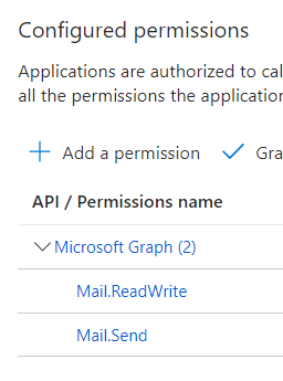

Hi All,
I am getting an error that "remote server returned an error: (403) Forbidden." we are using Application access in Azure AD and have access to both read write and send(refer below snip).
Authentication is success and able to receive the access token.
Any suggestions, what went wrong in this case..?
