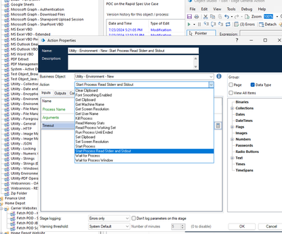

Hi, I can't find this in the VBO . Can you please specify which VBO has this functionality to check screen is locked ?
