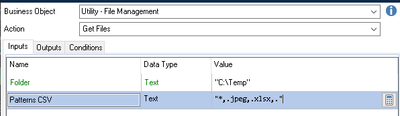

I have a process that a consultancy built for us years ago.  In my attempts to troubleshoot an issue I noticed that they were [consistently] doing something differtent than I might.  When calling the "Utility - File Management::Get Files" action, they use 'Patterns CSV' values such as:
  • ".jpeg"
  • ".xlsx"
The first one caught my attention because, just on muscle memory alone, I would have written "*.*".  The others would have had an asterisk/star in front of the dot.  I checked the documentation and it explicitly states that 'This is the way.'  But this process has been running, albeit imperfectly, for years.  And, if I open File Explorer in Windows 10, search based on each variation (including the "."), it returns the expected results.
So... In "Utility - File Management::Get Files", are wildcards necessary? Or are they implied?

asilarow
If I understand correctly, you are saying the Object in your process is used like so:
Is that right?
If so, then I would advise checking the code stage used, to see if it has been modified in some way.
  • The first pattern "*" will include all files in the directory.
  • The third pattern ".xlsx" will only match files named exactly .xlsx
  • The fourth pattern "." will match files with any extension.
In the original code, supplying such a pattern will mostly cause the "*" pattern to dominate (matching all files). However, the other patterns will not provide the intended functionality, as they don't correctly target files with .jpeg and .xlsx extensions.

Andrzej,
Your interpretations are in line with my expectations.  And that is really what got me thinking about this. The process, as written, seems to be performing as I think the consultants were expecting.  So either our mutual interpretations are not quite correct, or the consultants had something a bit different in mind.
