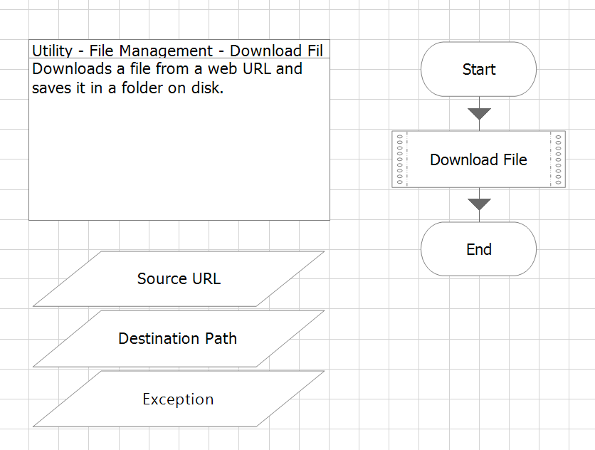

It is hard to say without capturing more error detail. For that, I suggest modifying the Download File action in the VBO to gain some additional insight.

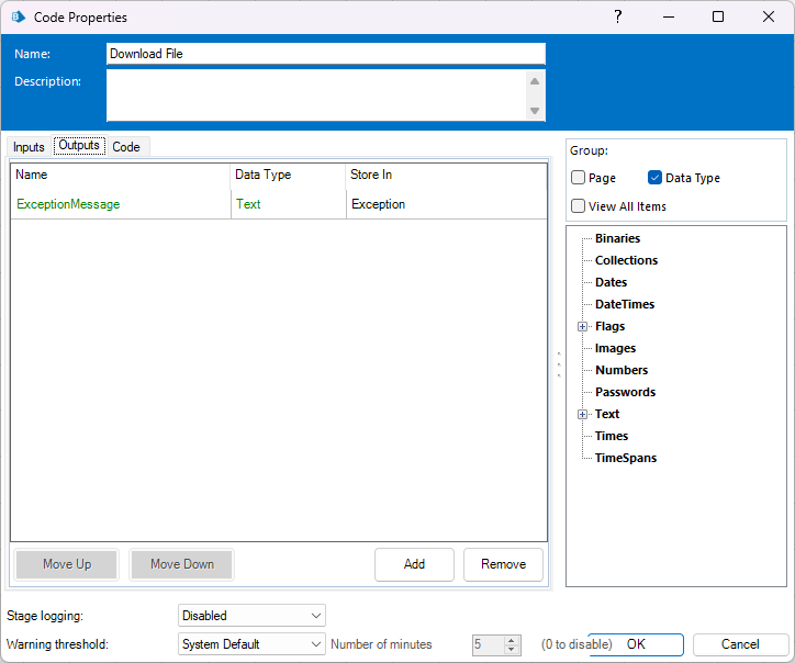

Add a Data Item (Text) named "Exception"
Add the Exception data item as an output parameter for the Download File code stage

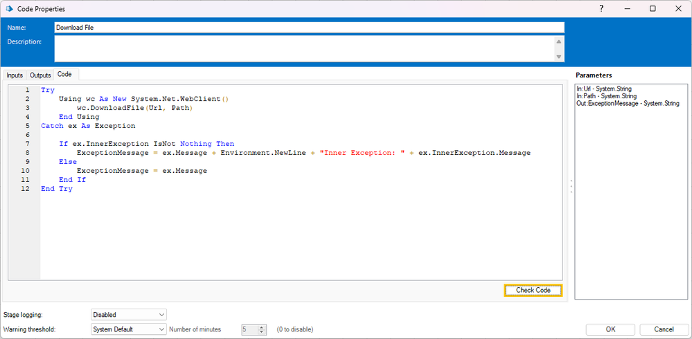

Edit the code stage to capture exception details when failures occur
Try
Using wc As New System.Net.WebClient()
wc.DownloadFile(Url, Path)
End Using
Catch ex As Exception
If ex.InnerException IsNot Nothing Then
ExceptionMessage = ex.Message + Environment.NewLine + "Inner Exception: " + ex.InnerException.Message
Else
End If
End Try

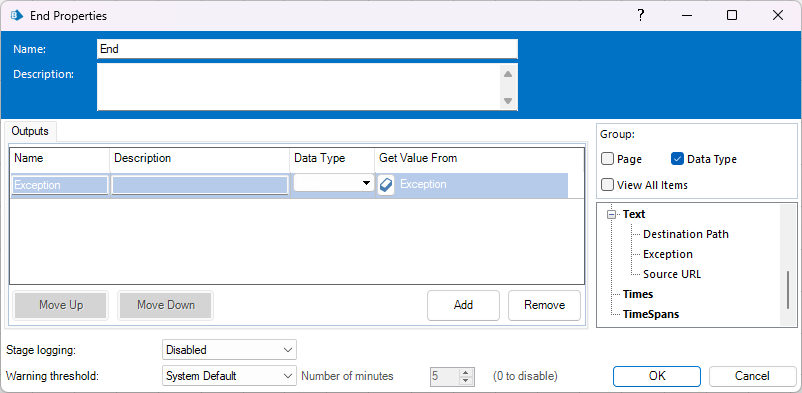

Make sure to add the Exception data item as an output parameter on the End stage for the action, so you can access it in your Process that calls this action.
When a failure occurs, this data item should contain the exception message and details, viewable in your Process session log that should help diagnose further.
