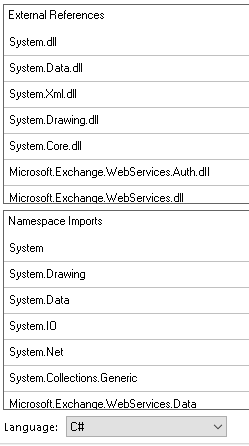

I have found a resolution for issue;
The fix for issue was to remove the below 2 x dll from Business Object Properties - Code Options tab;
Microsoft.Exchange.WebServices.Auth.dll
Microsoft.Exchange.WebServices.dll
and leave behind only
Andrew Le

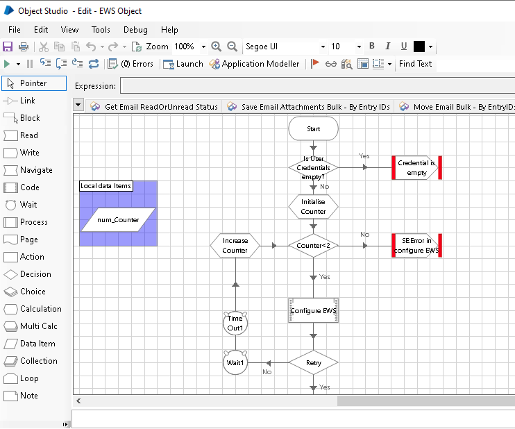

the VBO is Microsoft -> EWS Object
552.png553.png@Hosni Hussain
@Hosni Hussain
Andrew Le
Hi Karan,
I have checked in Studio, theres no warning/ compilation error.
I have tried to drag and drop to Resource PC but i have the same issue.

Hi Andrew,
In the object, go to the Initialise page.
Then you will see tabs for Global Code (where you can double check global changes by clicking Compile) and the tab we need "Code Options". Here you will see what dll's are being used.
You will need to check these are all present on the respective machine that's failing to run. If there's no file path, the file will need to be stored in C:\Program Files\Blue Prism Limited\Blue Prism Automate.

Hello @Ben.Lyons1,
Thank you for sharing an insight.
I verified the list of dlls within the Code Options and confirm that they are present at - 'C:\Program Files\Blue Prism Limited\Blue Prism Automate'.
To add, on the Digital Worker Machine, we tried to run the code in debug mode and we are able to run it end to end, however when we do a manual trigger (drag and drop) or through schedule it fails with the error shared by @Andrew Le.
