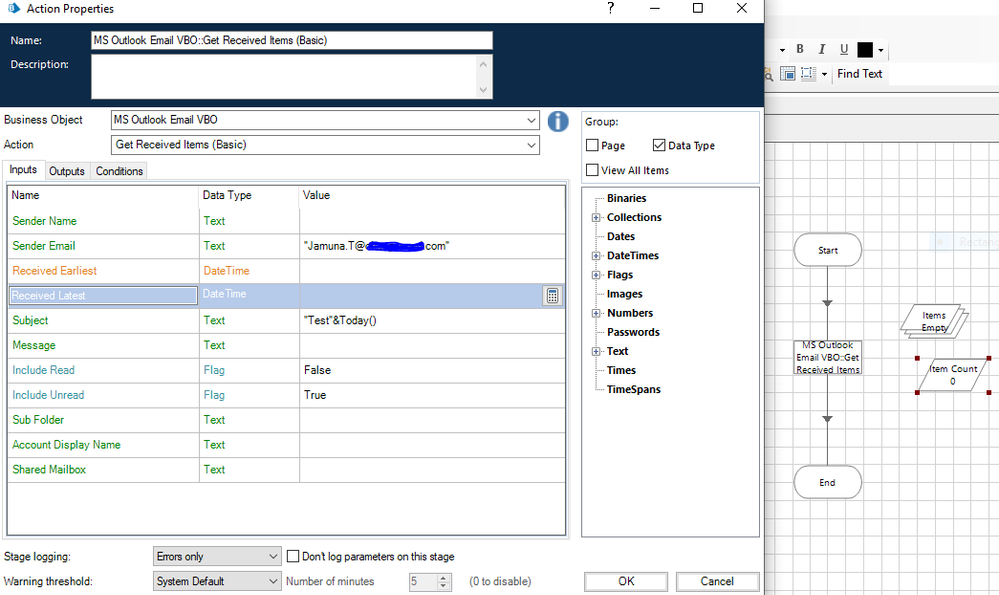

21-05-21 08:30 AM
Thanks for the response @Emerson Ferreira, Yeah I have opened BP with Active directory only from the remote machine & as per your suggestion informed to IT for administrator permissions .lets see.
Now I am trying to run the BP with my local machine by using the Get received Items (basic) action. In the local machine , didn't get active x component issue but I cannot able to read the mail and also didn't get any exception while running even tried the outlook with opened & closed.
I am not sure about input field which I am passing correctly in get received item action , kindly guide me how to give the input properly & what are the input must have to give in input field to get today received mail with particular subject & mail id. I have attached screenshot which I tried below kindly refer and guide me please. Thanks.
