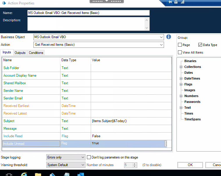

I need to download the attachment from outlook today mails , For that I have used get received item Basic action , I need to know what are the input must have to give in input field , I just tried input filed with  Subject  i.e [item.Subject]&Today() and Include unread  True .

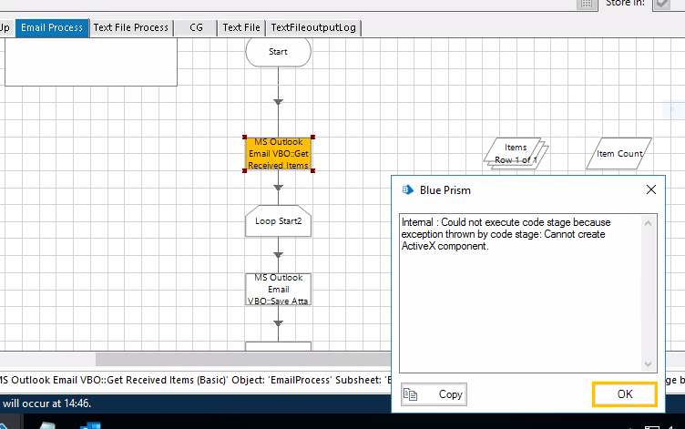

while running the script got exception like
Internal: Could not execute code stage because
exception thrown by code stage: Cannot create ActiveX Component.

If you can attach some screenshots and process/object here then we can try to reproduce the issue.

I have attached Get received items Inputs & exception screenshot , Kindly refer and guide me please.

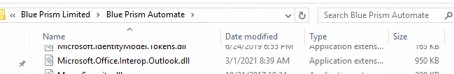

Thanks for the response @Emerson Ferreira.
Kindly refer the above screenshot , Office package installed in blueprism automate folder but still facing this issue
I cannot open the outlook from run an administrator in my remote machine,  I have opened & using the outlook for the BP from run as different user only ,
Is this fine to run the outlook from BP , Kindly provide the clarification & also the solution , Thanks.​
