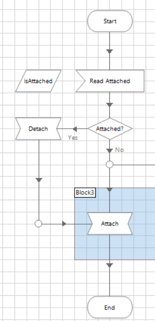

Assume the following flow, where you read if it is connected if you can activate and if in case it follows an execution and if it is not connected you use a browse passing the root element and give an attach

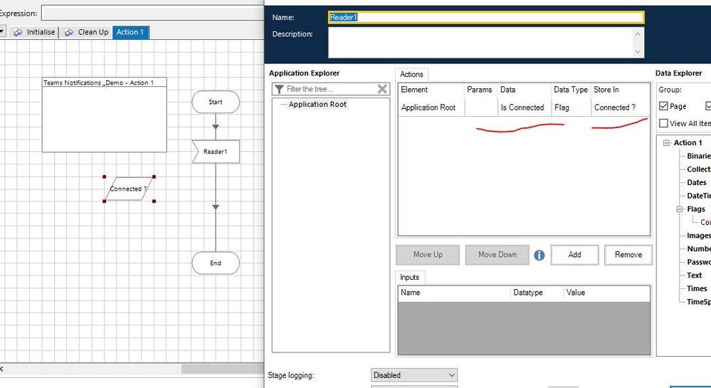

In case you wish to check if Object is connected or not , you can use the Read Stage shown below
You will have to drag and drop the root element and Select "Is Connected " in the drop down.
The output would be a Flag data item which would contain TRue/False depending on if the app is connected or not
I hope this helps
