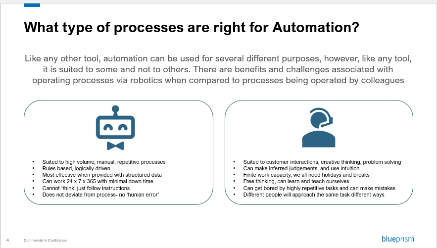

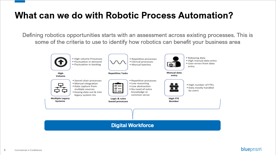

One of my favourite subjects in ROM!!
Whilst I'm a huge fan of the process and task mining tools there's so much more you can do before you get to this stage.
Workshops, education, engaging SME/Stakeholder/Automation Champions, leveraging more tools at but a few area.
We have lots of content available on ROM Hub around this topic but in it's purest form - Basic RPA this is a great start
and this
