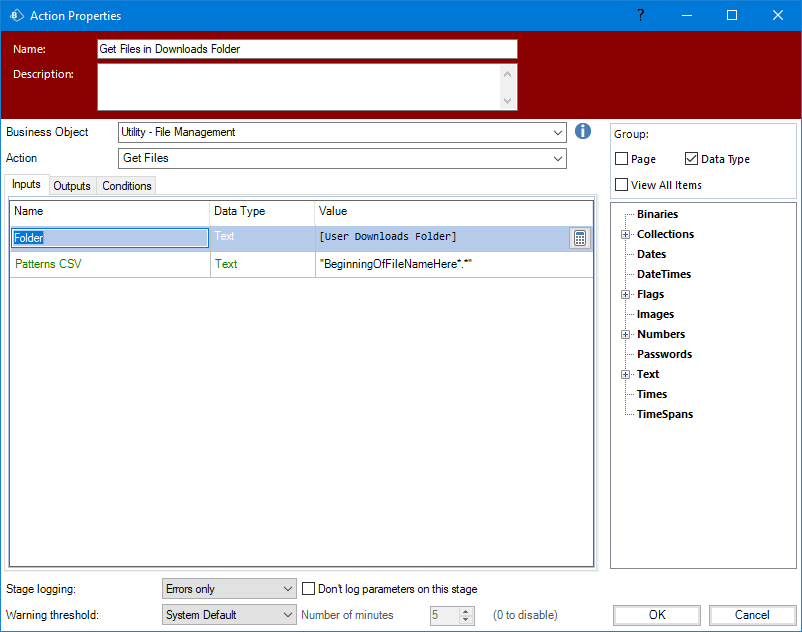

--If you know your folder (which it seems you do), you can also try using the "Get Files" action in the File Management Utility (Blue Prism canned object). That will get you all the files in a particular folder that match the criteria you set. If you know the first few characters and the extension, you can put "file*.*" in the "Patterns.csv" input to that action (see below). This action will give you output of a collection of all the files in that folder that match your criteria.
