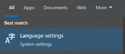

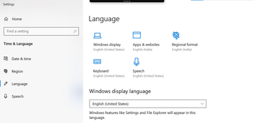

If this does not work for you then, you will need to search for the language settings on your machine from Search menu -> Language Settings
From here, once you know the language settings for your machine, then you can go through the suggested method that @Neel1 has mentioned.
