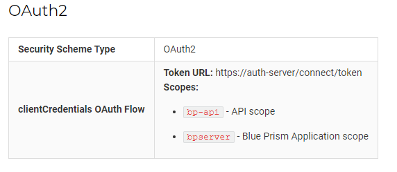

29-09-21 08:03 AM
I found this thread relevant with the issue I am facing...
I have done necessary installation for using Blue Prism API , web based control room.
How can I login to control room using Authentication APIs? I have downloaded Open API specification for Blue Prism 7.0.0 but for authentication I couldn't find API endpoint and payload.
By using authentication server URL how can I get oauth2.0 token to access further APIs of Blue Prism like for schedules and work queues.
Please assist me resolving this.
Thanks in advance.

29-09-21 12:33 PM
There isn't a specific authentication method that you call. There's an OAuth2 handshake that occurs during the regular RESTful requests. All of this takes place out-of-band via the HTTP headers.
There's a Postman Collection available on the DX that might help you visualize this. You can find it here: https://digitalexchange.blueprism.com/dx/entry/3439/solution/blue-prism-api-postman-configuration

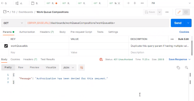

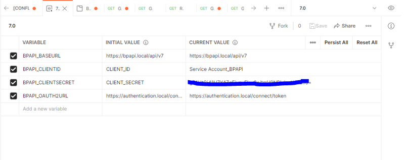

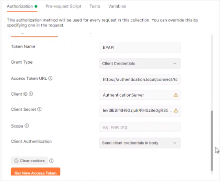

26-10-21 02:51 PM
Thank you for your response.
I have imported postman collection, While getting access token from https://authentication.local/connect/token if we mention scope as bp-api or bp-server it is not accepting , I am getting scope invalid error in console. But without specifying any scope I am able to get access token successfully.
Using same access token for authenticating other APIs facing below error. please find snapshots
Thanks & Regards,
