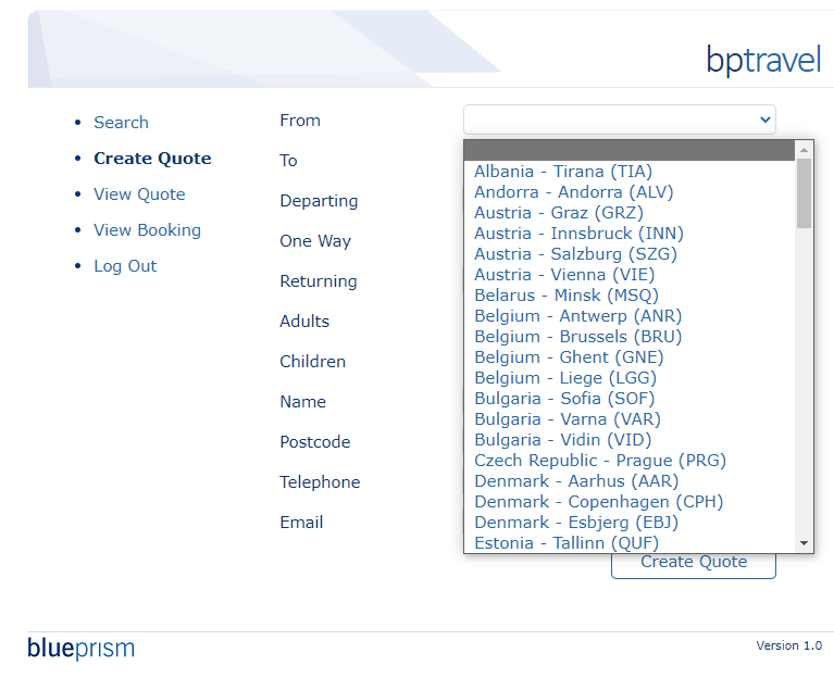

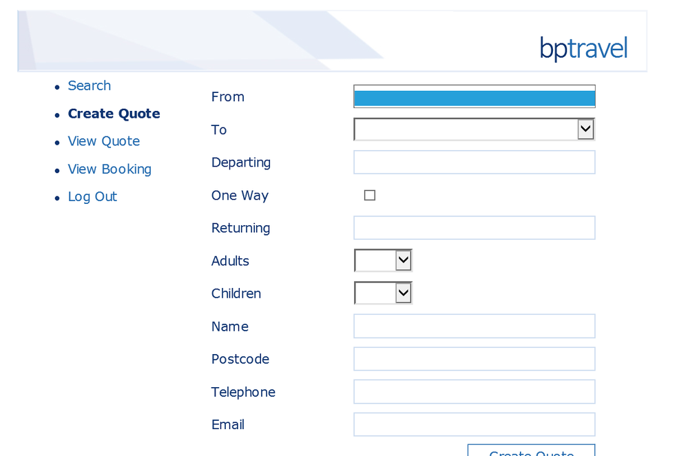

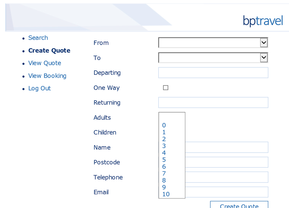

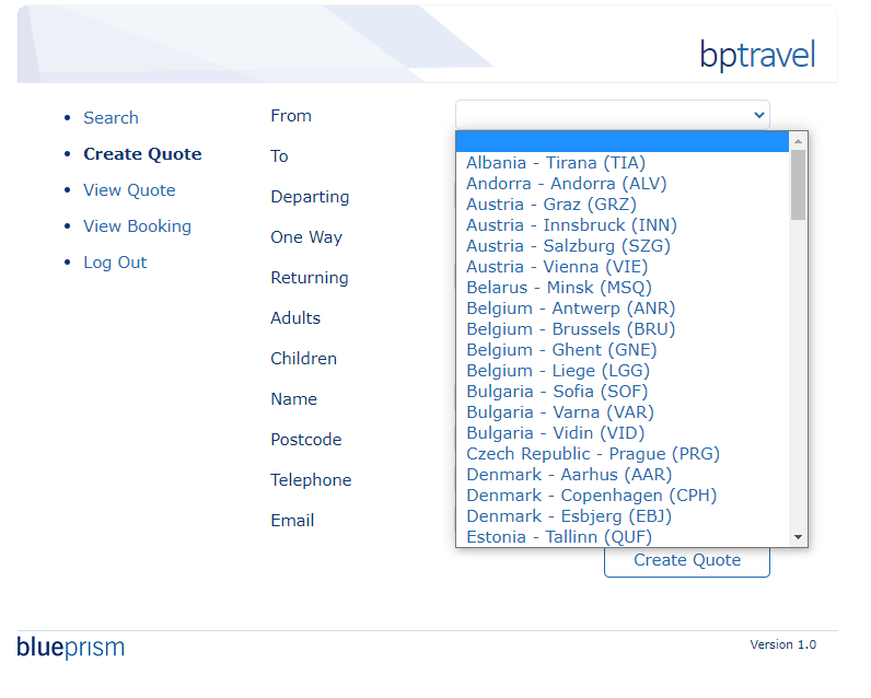

The problem is that the From and To combo boxes in the Create Orders page of the BP Travel site do not contain anything (when in IE mode). But they clearly do contain the locations when in Chrome and Edge (without IE mode).
Forgive my frustrations, but I have spent several days (whilst working full-time) amending these incompatibilities rather than actually working on the ACE itself and furthering my Blue Prism skills.
Please see the relevant screenshots below.
I anticipate that either the entire ACE needs to be redone using Edge or Chrome to make it a seamless experience for the learner. Or perhaps the lack of functionality with IE Mode can be corrected. Either way, this information should really be included in the learning material on the LMS website so that the learner can actually anticipate these problems and/or receive solutions to them.

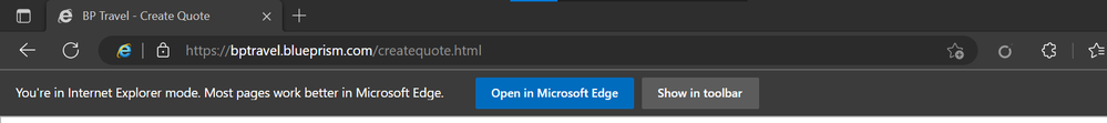

IE Mode of Edge.
Now on Chrome and Edge (without IE mode)
