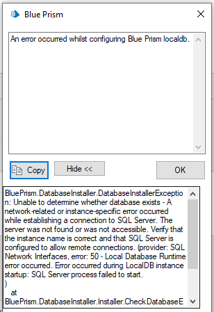

An error occurred whilst configuring Blue Prism localdb.
SureshRajendran
Please help me to resolve the below issue.
BluePrism.DatabaseInstaller.DatabaseInstallerException: Unable to determine whether database exists - A network-related or instance-specific error occurred while establishing a connection to SQL Server. The server was not found or was not accessible. Verify that the instance name is correct and that SQL Server is configured to allow remote connections. (provider: SQL Network Interfaces, error: 50 - Local Database Runtime error occurred. Error occurred during LocalDB instance startup: SQL Server process failed to start.
at BluePrism.DatabaseInstaller.Installer.CheckDatabaseExists()
at BluePrism.AutomateAppCore.LocalDatabaseInstaller.get_DatabaseExists()
at AutomateUI.BPApplication.Start(String[] args)

chris.strong
Hello Suresh,
Question: Have you previously had Blue Prism setup and running on this computer?
Rationale for asking: This error has been reported a few times and up to now we've been unable to replicate to prevent it happening.  It seems to occur when someone setups up Blue Prism Trial or Learning Edition, then removes some of it and attempts to install it again.  The reason for my question is to understand whether you have received the error is a similar way to other people or there is something else causing the issue.
To resolve the issue, the following steps seems to have resolved for other people:
To completely remove Blue Prism from your system:
As its previously worked, I suspect when you clear down and reinstall, everything should work again.  I suspect that Microsoft SQL Server 2017 LocalDB thinks the Blue Prism instance and database is still there, but you have removed them from the file system.
It would be good for the community if you let us know how you get on.  This will help the next person who sees this error.

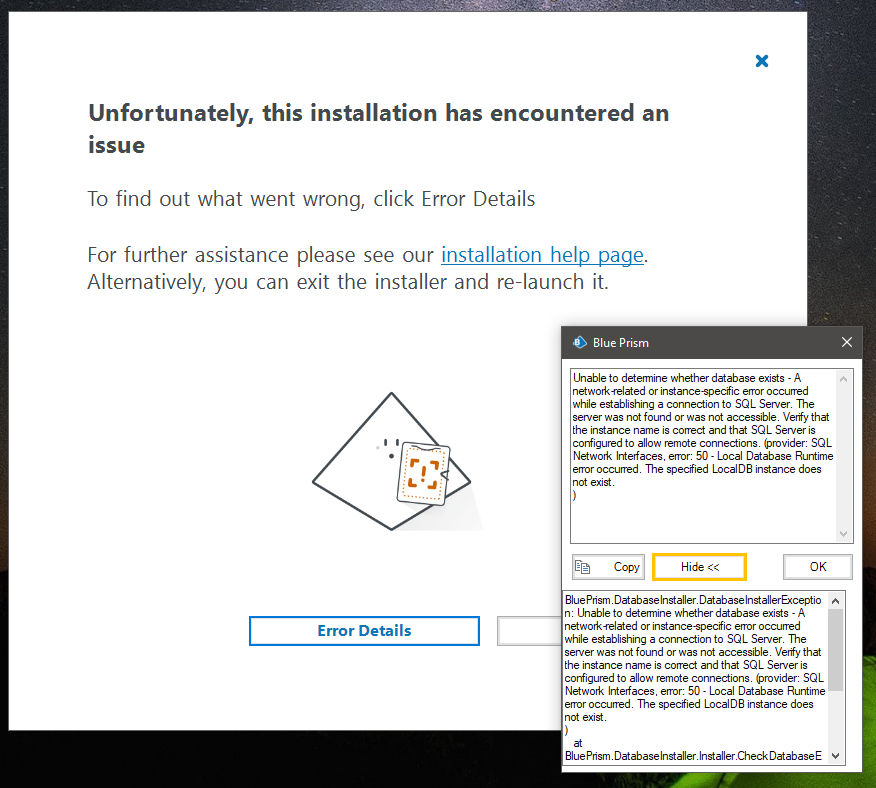

I am also experiencing this error on my first attempt to install Learning Edition, and again on my 2nd attempt after following the uninstall steps described above, from the Getting Started Guide - Blue Prism Trial and Learning Edition. I assume the complete uninstall was successful because I did get the first-time login screen with the option to enter a password for the Blue Prism admin user account. I am not able to follow steps provided by Nuno above because I am not a technical user. I am lost at the first step regarding SQLMS.. don't know what that is, whether it's on my laptop, nor do I know how to administer databases using that tool.
Thanks for any assistance,
James
I'm running 64-bit Win 10 on a Lenovo T470s. My local user account has admin rights to install software.
Here is a screenshot of the error:
Alan Hargrove
Even though I tried re-downloading the install file several times, for some reason when I re-downloaded the install file today, I was able to successfully install the Learning Edition and activate the license.

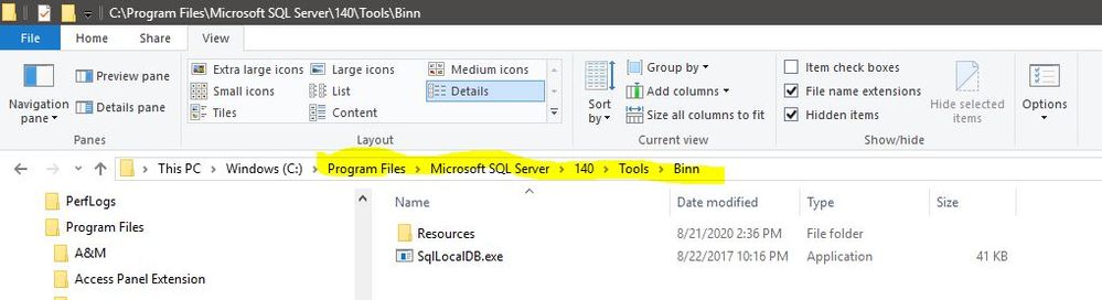

Regarding the uninstall instructions in the Getting Started Guide, I was not able to "run the following commands to stop and remove the local database instance" because I don't have any sub-directory "sqllocaldb" under the Binn directory.  Even after successful install, I don't have the sqllocaldb folder, I just see sqllocaldb.exe. See inserted image of my folders. I only have a Resource sub folder and sqllocaldb.exe.
I could not do these two uninstall steps from the Getting Started guide:
  1. • "C:\Program Files\Microsoft SQL Server\140\Tools\Binn\sqllocaldb" stop blueprismlocaldb
  2. • "C:\Program Files\Microsoft SQL Server\140\Tools\Binn\sqllocaldb" delete blueprismlocaldb
Alan Hargrove
