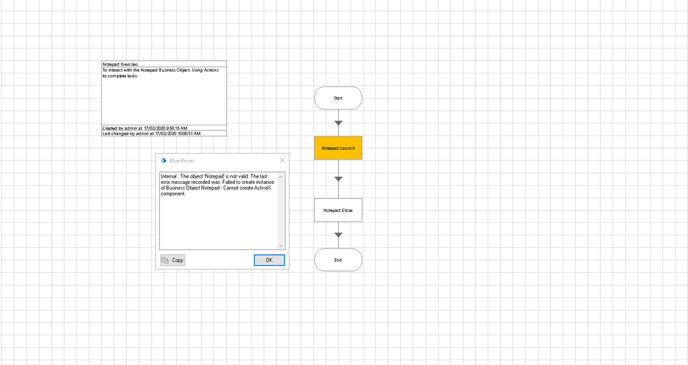

I'm currently completing the BP foundation training and I've come across a problem (shown in the pictures) where I cannot run my process because of a validation error it seems. I've looked through various different posts on the community forums and I haven't been able to find a solution, I hope that one of you can help me out. Thank you!

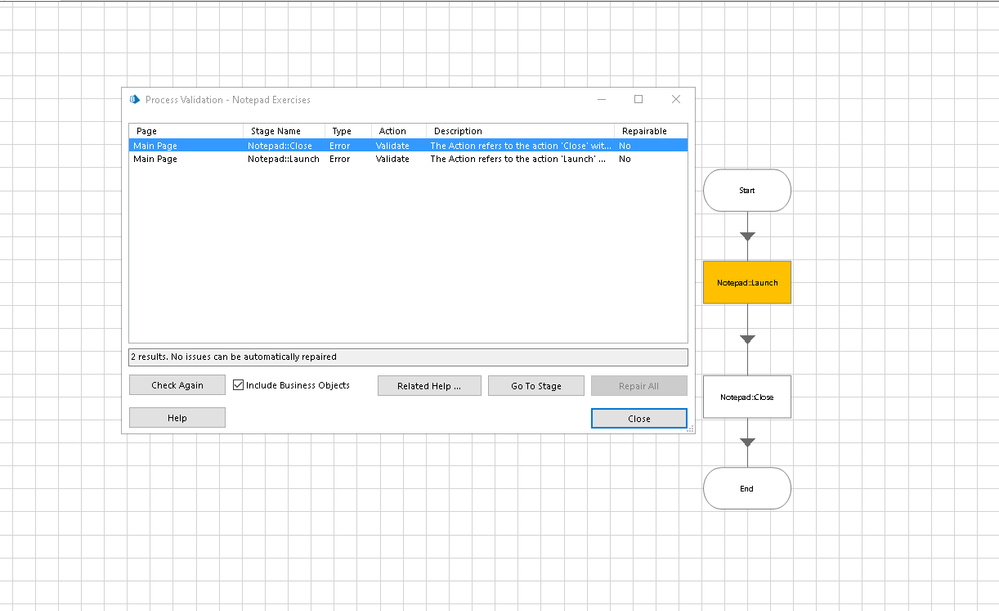

Can you expand the description on the process validation screen in your second screen shot? Seems to be a problem with your object, but I can't really tell.

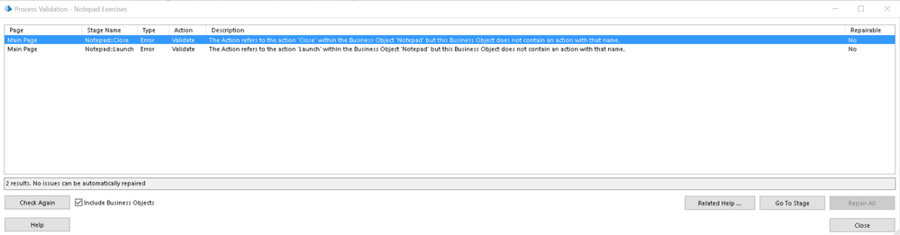

Here is the expanded description of the process validation screen. Thank you for your assistance.

This problem should not arise if you have created and published your object, refreshed your process and didn't create any orphan reference.
I would suggest:
1- Re-Import the notepad object (if you have it)
2- Close all BP instances and try again.
If the problem still persists, then you may have to delete the object and recreate it or create a new object with new name
