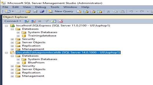

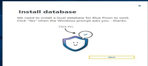

I am working on Upgrading BP platform from BP 6.4 to BP 6.10.
So when i use the BP Installer File(from Digital Exchange BluePrismEvaluation6.10.1) to Upgrade  in my Application Server i notice that the Blueprism Creates its Own Default DB instance instead of updating the Existing DB instance(its strange because in previous version we where able to Configure the Db connection) by clicking the "Upgrade Database".
PFA that shows the detail picture of the issue
Please suggest if someone have faced this issue and what needs to be done from my side so i i can Update the existing DB instance instead of BP creating the new One by itself.

Hi Manoj,
I don't see any attachments with your last message. Would you be able to show screenshots of your steps to the upgrade? We haven't heard of anyone else having a similar issue.

ManojKumar3
Level 6
Please find  my attachment in previous post.

gmarquez
Level 6
Oh I see what is happening now. You downloaded the evaluation version so, yes, it will install its own database. You need to download the official version from the portal here: https://portal.blueprism.com/products/enterprise
That will allow you upgrade your database.
