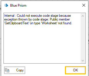

Hi, I'm trying to get an Excel worksheet as a collection but am getting the following error and I don't understand what I could be doing wrong. The worksheet name is correct, I've checked for spaces and spelling etc.  The worksheet name doesn't change. The contents are a mix of text and numbers that can be in date form or just as numbers... could this be it?

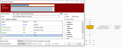

This is my action:
The workbook name is referenced from a different page.

Thanks for your ideas, the workbook name and worksheet name are obtained from the file - they change so can't be a set data item. I have checked and double checked the possibility that there were extra spaces in the Excel file worksheet, or the data item and there are none.  There is also a verify stage before the 'Get worksheet range as collection' to check the tab exists.
I tried both VBOs, the standard Excel and the extended.  I am using the same version throughout, and the issue persists with both VBOs.

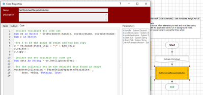

There is a known issue about reading and writing data from Excel but I have a Show action already built, which is the fix.
I have stepped through the action and can see that the workbook and worksheet are identified, and there, but it's at the last bit that it fails.  I wonder if there is something in the code?
I can't decipher it to know if there is something I could change...
