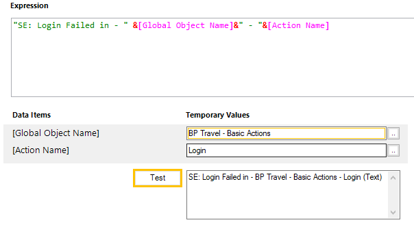

Tip of the day - Use Action Name, Global Object Name & Global Process name as a data item on all pages (Or In Main Page) of process and object layer. This can be useful in Exception handling messages to know the exact page where the exception occurred.

Very good!! I believe that depends a lot on the architecture of each institute, but without a doubt this greatly facilitates the reuzo and saves the developer time.
#Edit 01:04 PM
Taking advantage I believe that we could post in the channel of ideas that the Blue Prism itself could provide the name of the Object and Actio by function as it provides the Exception Details() or the GetClipboard() could be something like GetObjectName() and GetActionName()

Yeah, agree this is something we can suggest in the idea portal.

Hi, Tejaskumar,
Even though it is good idea if your process logging is turned on you can see the same information as part of the log.
