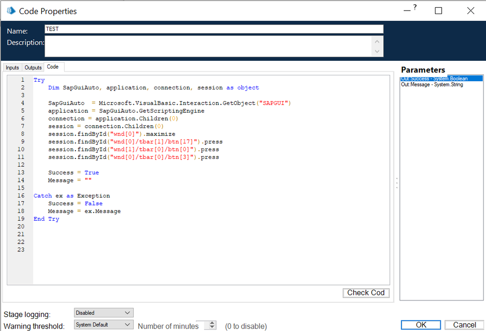

Hey guys, how are you? I hope you are well, I came to open a discussion about the best practices when using the code stage, I encourage you if you have any practices that you want to share, feel free.
I usually always place my codes inside blocks with Try Cath returning a flag and a message, in case of success the flag goes out as true and the message is empty, in case of error I set the flag as false and catch the exception message inside mine viable message.

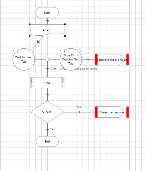

Right below the code stage I validate my execution through a decision, if everything went well with my execution he should finish the action without problems, otherwise he will launch a Throw with the detail of my error.
And Fluxo of the action.
