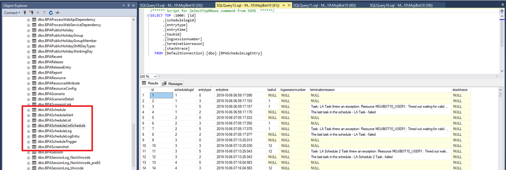

You can also check the scheduler in the database by using Microsoft SQL Management Studio.
