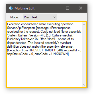

28202.pngHere it requires System.Buffer 4.0.2.0 but we got 4.6.28619.01 from VS. (Also tried to directly download 4.0.2.0 System.Buffer but not available on Nuget or any other web)
It seems like if one DLL gets fixed then another pops up hence we are struggling a lot to get this VBO to work.

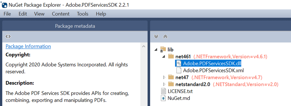

Hi Tejas,
You can try to download the latest version of the Adobe.PDFServicesSDK 2.2.1
Ensure you download the DLL from net461 folder as shown below and place it inside the Blue Prism installation folder:
When I tried the same on my Blue Prism v6.10.4 it is working without any errors:

Hi Tejas,
Thank you for being an SS&C Blue Prism customer and for using Blue Prism. The issue you are experiencing is because of how the .NET framework handles backward compatibility. In .NET, when an assembly has been updated and a new one is available, applications can use what is called an assembly redirect to redirect calls for an old assembly to a new one. This is done using the app.config file. Unfortunately we are not able to use this route with Blue Prism so we need to tell our code to redirect at runtime, using code.
Please could you check you have the latest version of the asset and also the latest version of the PDFServices package, as Devneet has already recommended. The latest version of the DX asset will have a global code function as shown below.

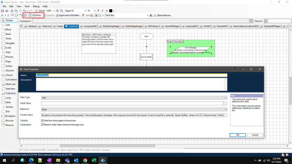

Thank you Devneet for your response.
I'm using BP 6.10.4 and Adobe.PDFServicesSDK 2.2.1
This time I tried to take a new DLL from the net461 folder as you suggested but notice the same error.
And it does not throw this error in the blue prism studio but when any action is run that time it throws this error in the Output data item.
