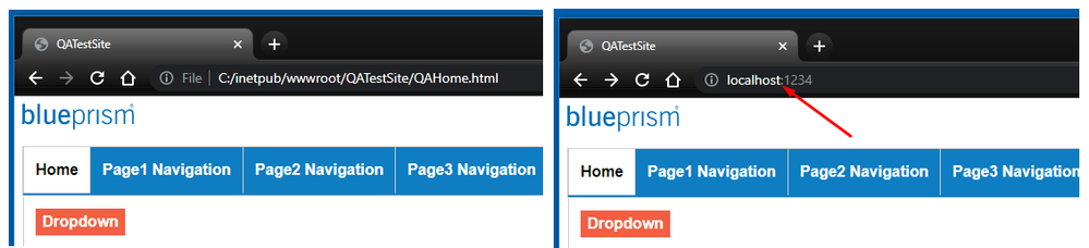

I'm seeing the same thing guys. HTML content served as web content (below right) can be spied, the same HTML opened as a file (below left) cannot. My guess is that the extension only 'sees' traffic from a web server.

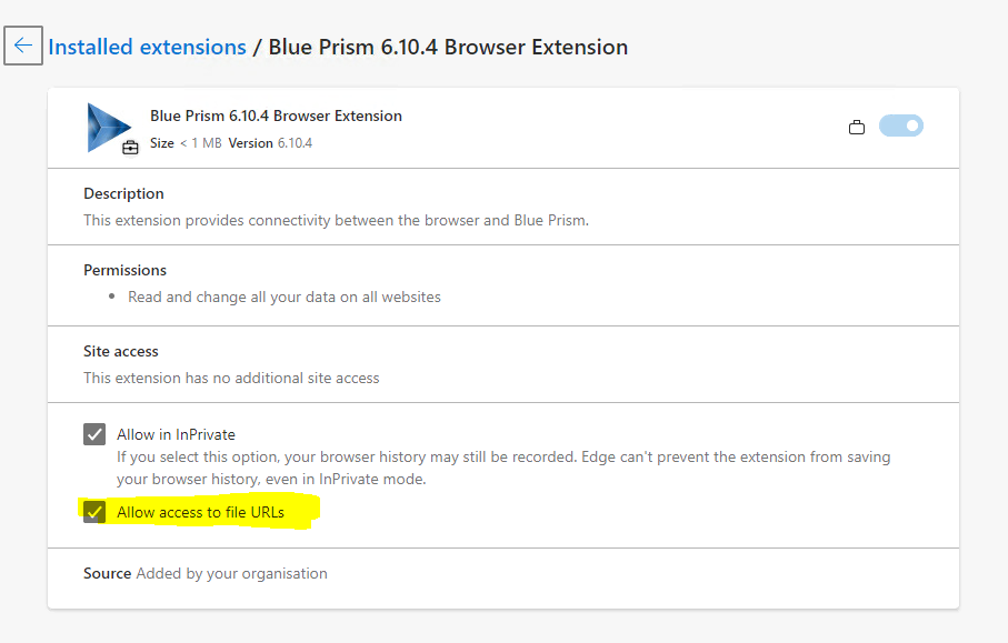

I was facing the same issue with a .HTML file that was stored locally.
I think I might have just resolved it though, as I can now use Browser mode to spy it.     I have been trying quite a few different settings though, so I am not 100% if this change is what fixed it.  ( I also turned off the 2 top settings on edge://setttings/system  - "Startup Boost" and "Continue running background extensions" )
I took the following steps:
- Right click on extension in Edge
- Select Manage Extensions
- Tick the option "Allow access to file URLs"
@John Carter - are you able to replicate this and confirm that this is the fix?
