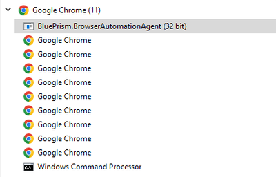

3 - Make sure the BAA process is actually starting up / running. I haven't used BAA much in favor of trying the newer versions of BP that have this built in, but in the newer versions the process starts up underneath the Chrome/Edge process, but again the article gives some information on what to look for in Task Manager.
