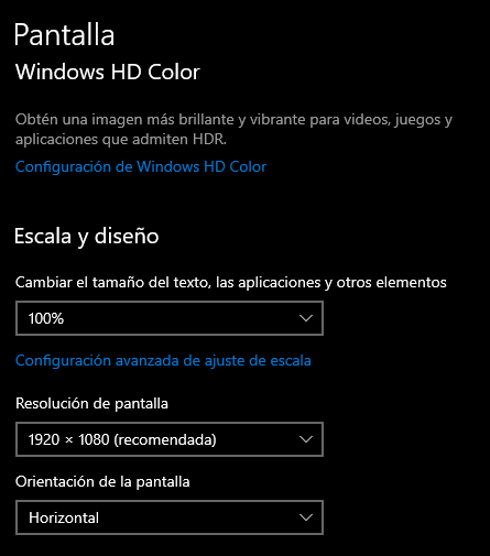

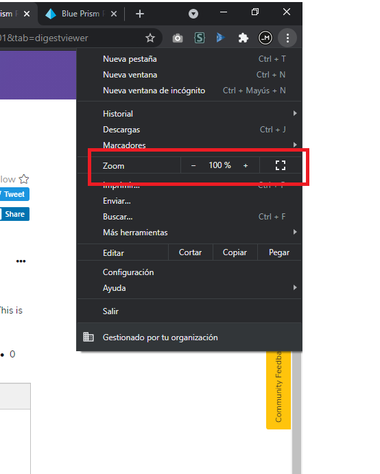

The offset may be caused if you have zoom in your browser or in your windows setup.
Have you experience this offset with other elements inside the web page or only ocurred with the SQL Editor component?
Perform the reviews i mention below in order to try to fix the offset.

Verify the zoom inside your browser.
Verify the zoom value in your screen windows settings.
