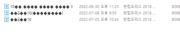

We're using "Utility - Windows Compressed File" VBO for unzip a compress file.
The result is as below:
Any one knows how to prevent the character from being broken?
Or Is there any other VBO or ways working without a concern for the character-set?

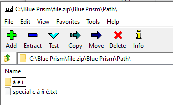

As you can see here, I have several special characters in this paths:

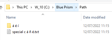

Here is the result:
