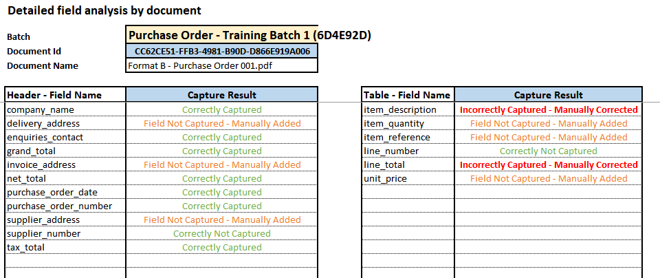

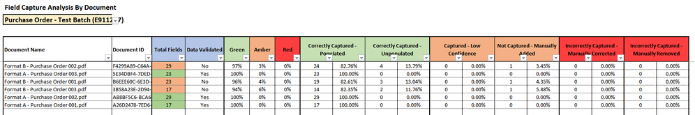

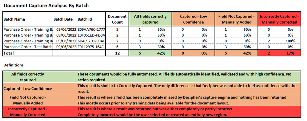

I hope my reporting process will help bridge this gap in the near term, here's a couple of screenshots to give you an idea of what's coming.

The data used to populate the Excel report is more raw than what is represented in the report, all the colour coding and phrasing is just how I've formatted the report.
