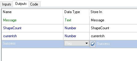

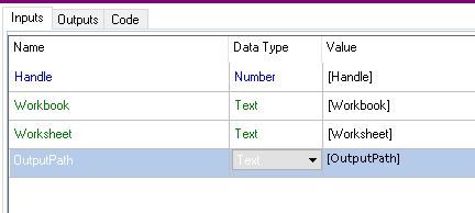

Hi Robert,
Can you also share the input and output parameters for the code stage
Nikhil Negi
14423.jpghere you go
Robert New
Senior Mentor / Developer
Smart Automation Services Limited
Unable to find the image.
Here is the screen shot of VBO
This is the message output after running the code
Message: TValue get_Item(TKey);The given key was not present in the dictionary.

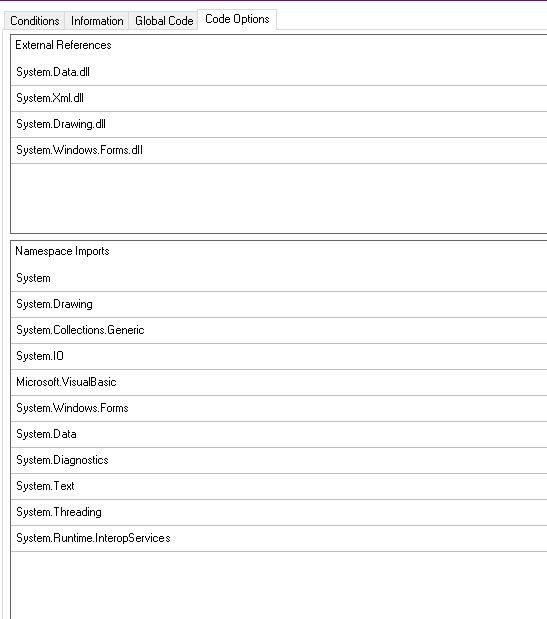

you will need to make sure the following are in the initialise stage. I can't actually remember where I got the imports for it, so after this you will just have to play with it, sorry.
Robert New
All the References and Namespace are there in the VBO by default, still I can't see any results
