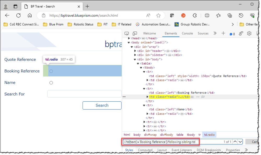

@DanielPacheco
You can also use XPath Expressions in the "Web Path" attribute. This can give you the ability to target an element relative to a more identifiable element. XPath Expressions look daunting but once you get the hang of them, they are easy to work with.
Take for example the page in the BP Travel example web site. There are three radio buttons that are indistinguishable from each other but using XPath Expressions, you can identify them relative to their labels. The "Web Path" attribute, with the XPath Expression will find the correct radio button no matter how dynamic the page is.
