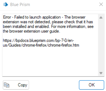

I am unable to launch chrome due to multiple profiles in my chrome application. When I am trying to launch chrome it will first ask to select the profile. I suspect it is due to this the launch is getting failed. Below is the attached screenshot of the error message.
Could you please help me to resolve this issue?

I have also 2 Profiles in my chrome application , Make sure the Blue Prism Browser Extension is Enabled in the account in which you wish and Click Update in the Extention window also.

There's a command line argument for Chrome called "--profile-directory=XXXX" (where XXXX is the name of the profile ex. Default) that tells Chrome which profile to use at startup. You might try that in addition to the steps outlined previously w/r/t ensuring the BP browser extension is working.
