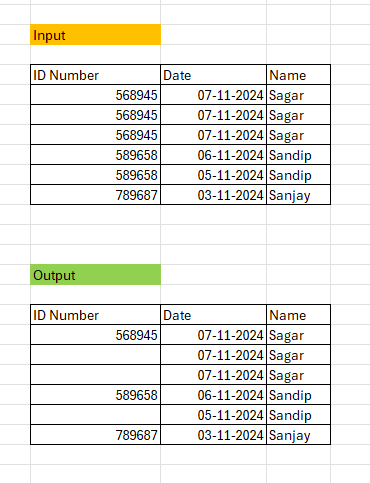

Hi Everyone,
Please assist me in getting the VB code for Blue Prism to clear duplicate values from an Excel sheet.
For reference, kindly refer to the attached image.

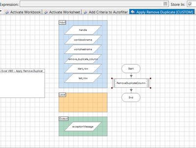

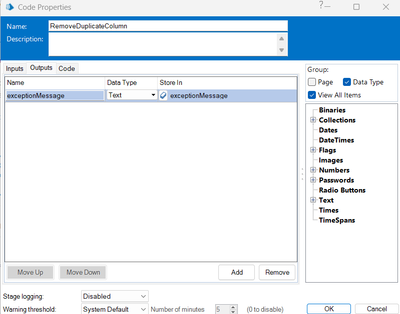

Go to MS EXCEL VBO and add a new action, name it 'Apply Remove Duplicate [CUSTOM]'. Then drag and drop a code stage like this :

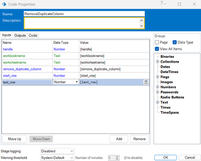

Now open the code stage and provide these inputs :
Do the same for output :

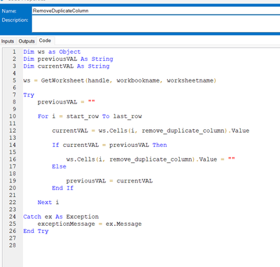

in code stage put this :
Like this :
Now, Your action should look like this :

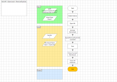

Publish your action, save and go to process now.
Your process should look like this :
Lets do the test now.

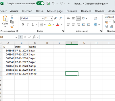

I have this excel file see below :
I want to make the remove duplicate on my column A so its my first column.
I want also to start at cell 2 and finish at cell 8

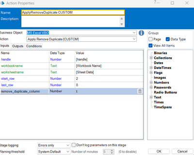

so i give these parameters in my new action see below :
now run your flow and you will have this :

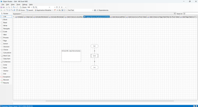

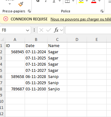

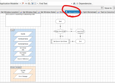

By the way you can use the latest version of MS EXCEL VBO in DX : https://digitalexchange.blueprism.com/dx/entry/3439/solution/ms-excel-vbo
you can find this action :
Try it and let us know if it work for you mark me as best answer
