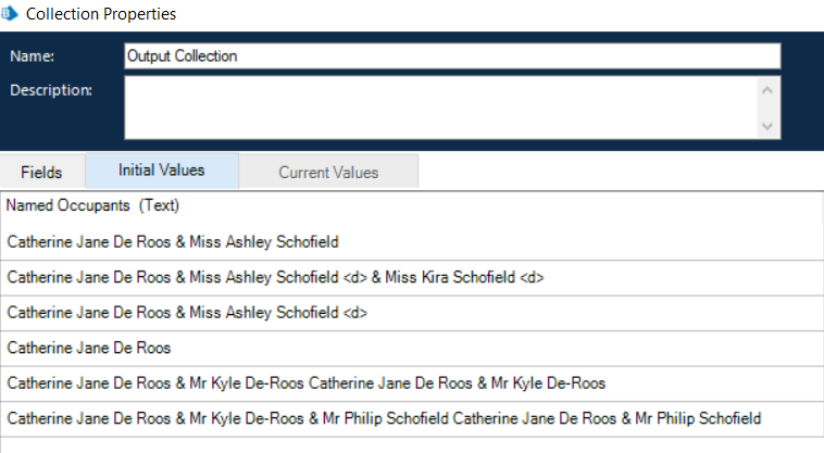

Basically, I just need my initial Collection to have 1 instance of the string of text within the Named Occupants column. So looking at my screen prints you can see that the first row has
Catherine Jane De Roos & Miss Ashley Schofield Catherine Jane De Roos & Miss Ashley Schofield
Within it.....
I just need that column within the Collection to have:
To make things more interesting then sometimes there is a & or <d> but not always, so there isn't always an Identifier to split the text by.

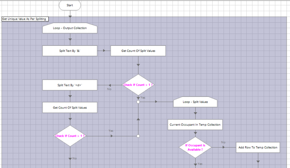

Now diving into the solution, the first half of the solution looks something like below:
1) Here, I first loop through the input collection where I got a single column of the Named Occupants with me, in my case I call it 'Output Collection'. Please don't go by the name of the collection and consider it as the input of this solution only.
2) Within the loop I first use the 'Split Text' action and provide the input as the input collection name, the field name I want to split and '&' character as the character to be considered for splitting.
3) I store the value in 'Split Values' collection. Next, I check if the row count of the collection is greater than 1, if yes then loop through the 'Split Values' collection and check if the current named occupant exist in the 'Temp Collection'.
4) This 'Temp Collection' we would create at the design time having the same field structure as our input collection ('Named Occupants' field of text type) with no rows or data. If the current Split Value exists in the 'Temp Collection' skip the iteration and check for the next  value in 'Split Collection' otherwise we add the row to 'Temp Collection' and set the current value of 'Split Values' collection to the added row field of the 'Temp Collection'. Once the iteration in 'Split Values' complete we proceed to the next iteration for the 'Output Collection'.
5) If the row count of 'Split Collection' for '&' operator was not greater than 1, we would move with the next Split character '<d>' and repeat the same steps as above.

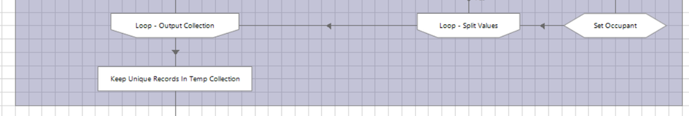

All these steps will continue till we process for all rows in the Output Collection and finally we would call the 'Keep Unique Values In Collection' action which I shared with you at the very beginning of this thread to remove any duplicates found.

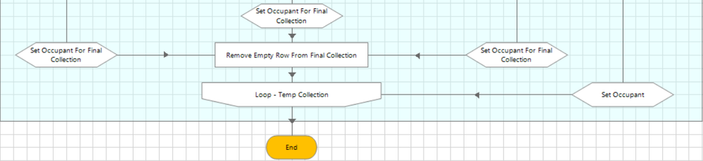

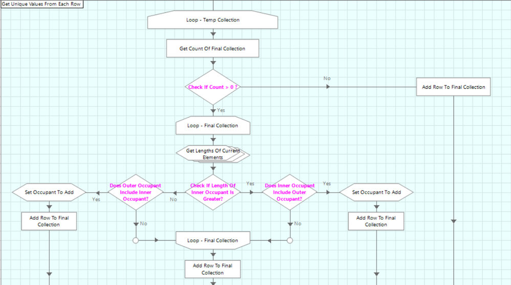

In order to get rid of the second problem, now we would apply the second part of the solution: as shown below:
6) In this part of the solution, I would iterate through the 'Temp Collection' and first get the count of our output collection for the solution which is 'Final Collection'. This collection also will have the same schema as the 'Temp Collection' ('Named Occupants' field of text type) but will not have any rows or data. If the count is zero, it means that it is the very first record we are checking for 'Final Collection' so simply add a row to this collection and set the 'Named Occupant' field value of 'Temp Collection' to the newly added row of the 'Final Collection' and we proceed with  the next value of the 'Temp Collection'
7) Now if the row count of the 'Final Collection' is not zero (From second iteration of 'Temp Collection' we will always have this condition as True), we will iterate through the 'Final Collection' and will retrieve the length of the current 'Named Occupant' field from the 'Final Collection' and 'Temp Collection'.
😎 Now we will be first checking which of the length is greater among the two so that we can decide how to use the InStr function to check the presence of the 'Named Occupant' field in either of the collection. If the length of 'Named Occupant' field in 'Final Collection' (I have mentioned this as 'Inner Occupant' in my code) is greater than the length of 'Named Occupant' field in 'Temp Collection' (I have mentioned this as 'Outer Occupant' in my code) then we would check if the Inner Occupant is included within the Outer Occupant by using the following expression: InStr([Final Collection.Named Occupant],[Temp Collection.Named Occupant]) > 0  If this expression is True then we can say that the Inner Occupant is included within the Outer Occupant and we would remove the Outer Occupant from the Inner Occupant using the following expression: Replace([Final Collection.Named Occupant],[Temp Collection.Named Occupant], "") and then add a new row to the 'Final Collection' and set the replaced value to the 'Final Collection'. We would then remove the empty rows from the 'Final Collection' and proceed with the next iteration in the 'Temp Collection'. In case above expression was False, then we would skip the current iteration for 'Final Collection' and move with the next row in the 'Final Collection'.
9) If the length of 'Named Occupant' field in 'Final Collection'  is not greater than the length of 'Named Occupant' field in 'Temp Collection' as mentioned in Step 8, then we would check if the Outer Occupant is included within the Inner Occupant by using the following expression: InStr([Temp Collection.Named Occupant],[Final Collection.Named Occupant]) > 0  If this expression is True then we can say that the Outer Occupant is included within the Inner Occupant and we would remove the Inner Occupant from the Outer Occupant using the following expression: Replace([Temp Collection.Named Occupant],[Inner Collection.Named Occupant], "") and then add a new row to the 'Final Collection' and set the replaced value to the 'Final Collection'. We would then remove the empty rows from the 'Final Collection' and proceed with the next iteration in the 'Temp Collection'. In case above expression was False, then we would skip the current iteration for 'Final Collection' and move with the next row in the 'Final Collection'.

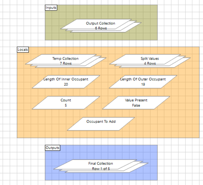

The variables that are used in the solution are:
I hope my explanation was clear as I can't share the bprelease file directly, though please take your time and go through it. Do let me know if you have any questions. Would be glad to help out!
