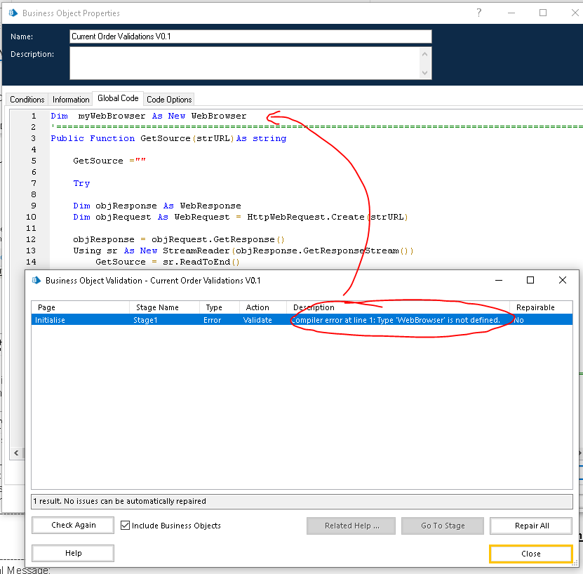

However when trying to break this down and write code stages, Blue Prism throws errors on these libraries and reports that these are not recognized objects. The error is thrown on the 'webBrowser' object in this case.
I'm guessing it's more likely a syntax issue
I had to import an HTML library for the Excel module to work which I don't see in the .Net, but as you say the code is very similar otherwise.

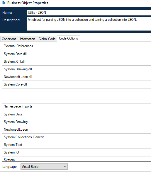

Hi Gavin - it's not quite as easy as that. Instead of writing an Imports statement in the code, you need to make an entry in the Code Options of the VBO. Go to the Initialise page and double click the 'nameplate' element to open the object properties. In there select the Code Options tab and see that there is a section for references and a section for imports. Take a look in the Utility - JSON object to get the idea:
Note also that there is a Global Code section where you can classes and functions etc.
John Carter

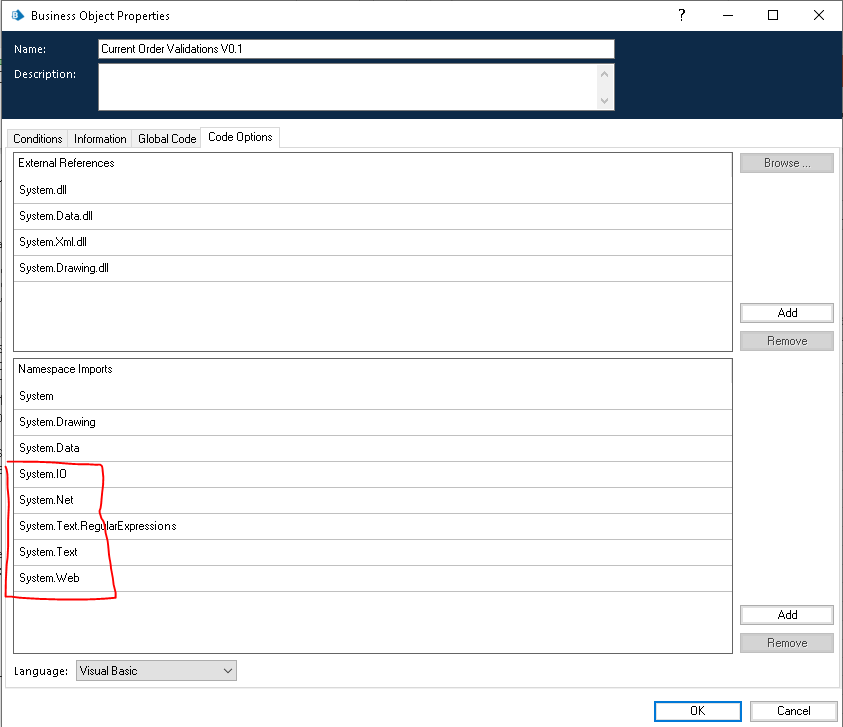

Thanks John
That is one of the reasons for this query.
I have added the namespace Imports, as I thought, but my lack of knowledge / experience with this functionality of Blue Prism, seems to be catching up with this old brain.

Hi you first need to have your library referenced in the upper section, then you can add a namespace import, or alternatively use a fully qualified class name in your code. Not sure which library you want but there is WebBrowser class in System.Windows.Forms

Thanks John, I think I found the correct Dll file "System.Windows.Forms.dll".
At least I can move on to the next step.
Much appreciated.
