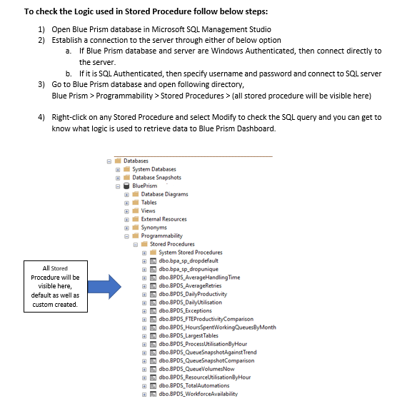

In the attached image, you can see I've created 3 new SP and it is visible under Data Souce dropdown (Named as Demo, Demo1 etc at the bottom)
Hope this helps to create customized tiles in Blue Prism.
