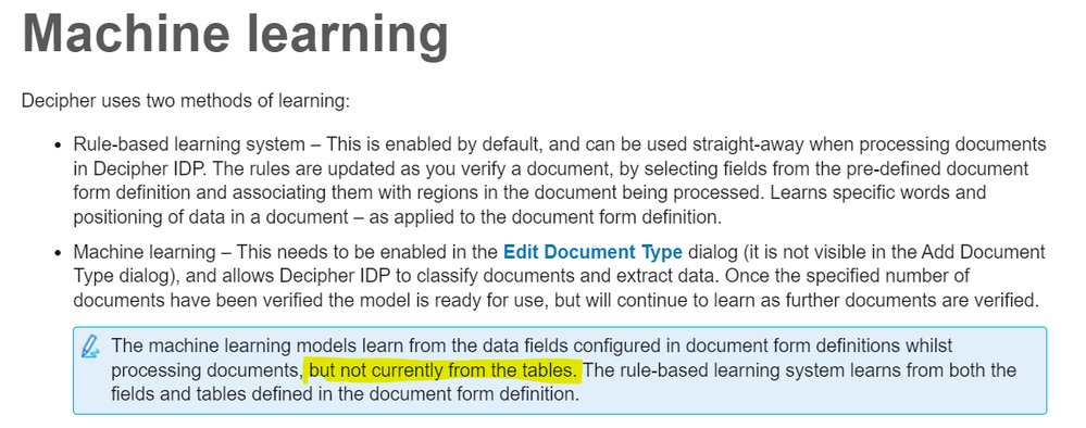

Hi Harpreet,
Based on Decipher documentation the 'Machine Learning' is not applicable for the data coming from the tables. Please see the highlighted text below. My problem is related to the trailing 5 digit read in the table. Perhaps I should have been clearer. Please could you confirm whether there is any other option rather than improving the PDF visual quality exists OR totals check which I am doing currently?

Hi Kalash,
If the confidence of a value is high, Decipher's unlikely to change the result over time. This comes down to the 2 confidence values it uses for retrieving data, the first is OCR confidence and the second is capture confidence. If the OCR confidence is high, this won't be automatically changed. So as Harpreet has suggested, in a digitally created pdf, where the value may be incorrect, the confidence will be 100%.
Please can you share a screen shot for the DFD and that part of the document?

Ben,
We raised a ticket 207044 for this. The information is attached to the ticket.
Kalash
Kalash Sharma
IA Consultant
Hi Kalash,
Thanks for sending that in.
Our development team are on the case and we are hopeful of having an update in v2.2 (due in June 2022) to better handle these types of fields. Once I get a chance to test it, I'll be able to confirm.
