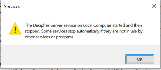

I tried installing decipher on my local machine. Post successful completion of installation, i can see that Decipher server service is not getting started. I tried uninstalling and installing the Decipher IDP components, also tried to perform the steps mentioned in the troubleshooting documents but no luck.

Error message screenshots :
Event Viewer Error Message :

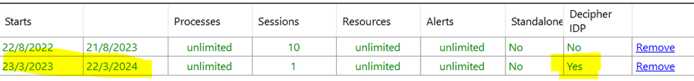

License Status : Active

Hello All,
On further analysis, i have found that i missed to add SQL connection string in Web.Config file ("C:\Program Files (x86)\Blue Prism\Decipher Web\Web.config") and followed the steps mentioned in the below link. Now I am able to access Decipher via locahost.
https://bpdocs.blueprism.com/decipher/getting-started/decipher-configuration.htm#Add
