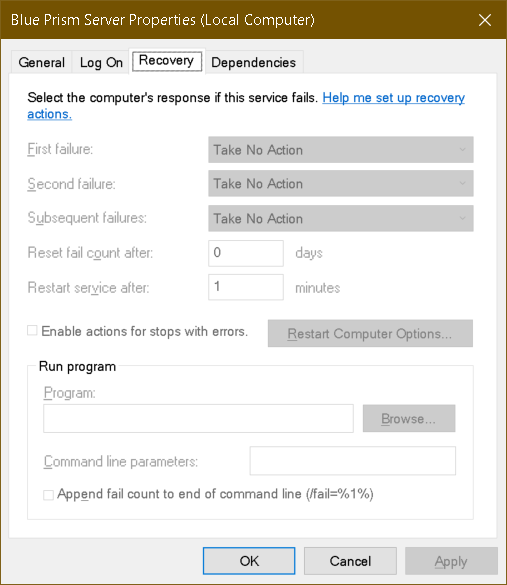

HI guys,
I had same issue. Actually i didn't notice what is the cause. But I suspect it being an internal error in the decipher. anyway what I did to solve was have retry logic on the Windows Service incase of failure. It have solved my issue and I have not noticed the issue again
Below picture show the wrong services, but I just changed the at first failure to retry for the Decipher service which failed
