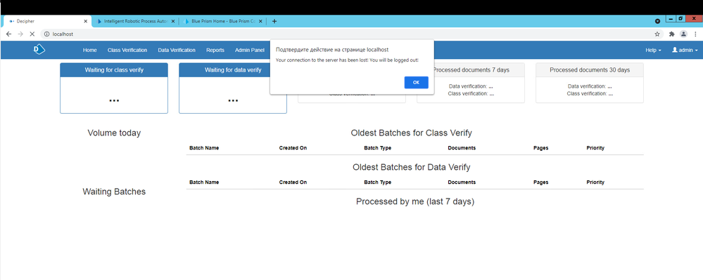

Hello everyone!
Faced a problem after installation, when entering the Decipher server web page (localhost 80), I receive an error message (in the screenshot). Many times we reinstalled, changed the SQL server (local, network), changed versions of the rabbit, different options for passwords and logins - nothing helps the error is the same. Judging by the text of the error, this is an internal Decipher error.
Any ideas please 🙂

SergeiEvdokimov
Thanks for the question.
No, rebooting doesn't help. The error is repeated.
All services are running, including the rabbit.
All components are installed on one machine. Except SQL server, but when connecting to local SQL express, the error is exactly the same.
SergeiEvdokimov
I was unable to locate any logs for this error. Does anyone know where to look for them?

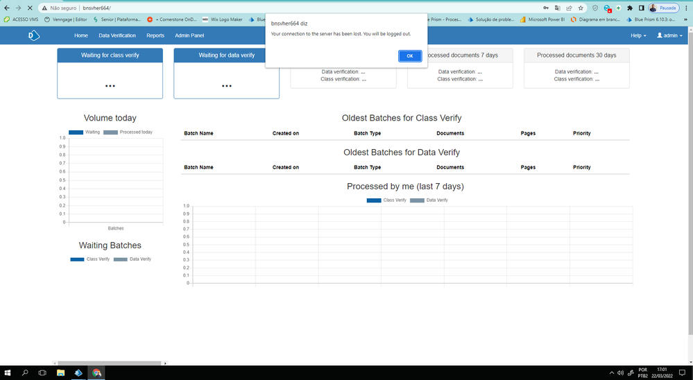

Hi guys,
I'm having the same problem as Sergey.
I have already uninstalled the antivirus, but the problem persists, has anyone found a solution??
SergeiEvdokimov
For Jonathan
I think you should look at the Decipher log files the moment you get the error. As well as the windows log in the event viewer.
You may see an error when connecting to the database to check the license or something like that.
