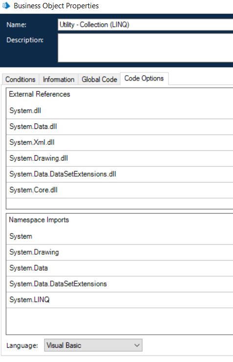

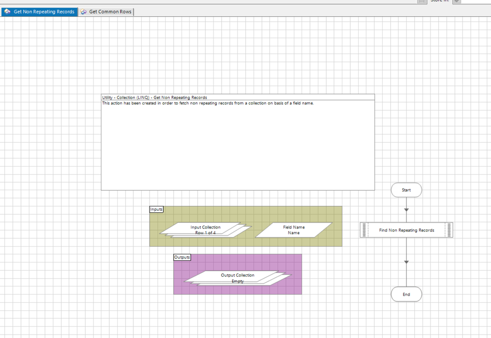

You can create a new business object and add the below External References ('System.Data.DataSetExtensions.dll', 'System.Core.dll') and Namespace Imports ('System.Data.DataSetExtensions', 'System.LINQ') on the Page Description stage of your Initialize action for the LINQ queries to work properly. Also, ensure that the language is selected as 'Visual Basic':

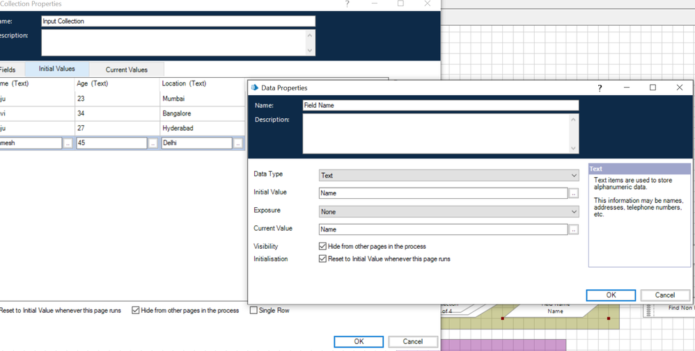

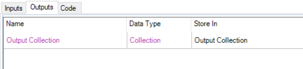

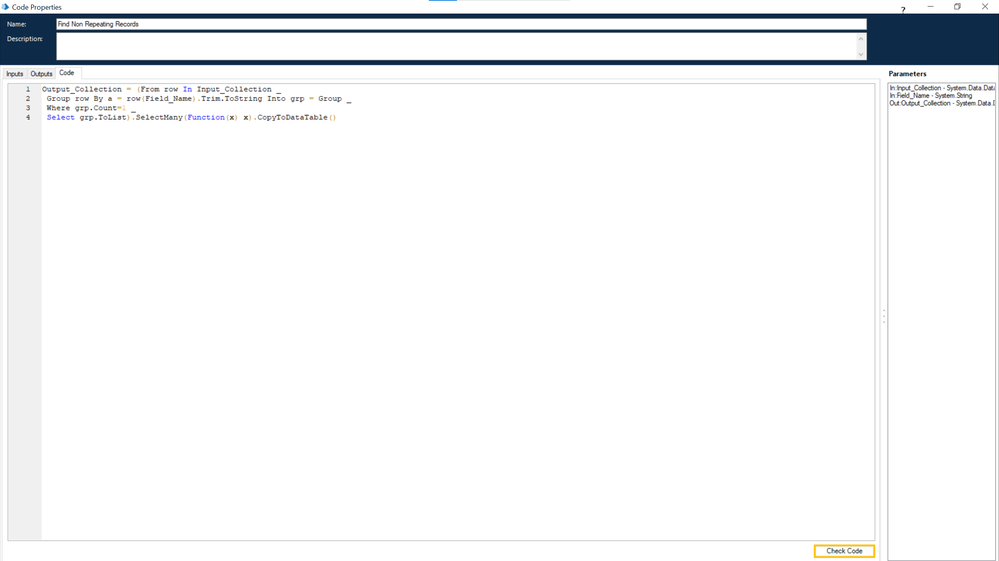

Once you have the updated code options as shown above, create a new action named 'Get Non Repeating Records' and pass two input arguments, Input Collection (Collection) and Field Name (Text). Based on the field name that you provide the duplicate records will be fetched from the Input Collection. Also set an Output parameter as Output Collection (Collection) for this action as shown below:

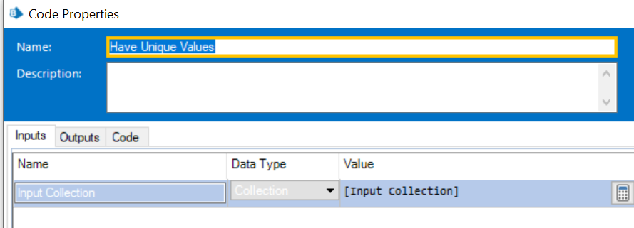

Add the code stage and use the below code with the input and out arguments as show:
Output_Collection = (From row In Input_Collection _
Group row By a = row(Field_Name).Trim.ToString Into grp = Group _
Where grp.Count=1 _
Select grp.ToList).SelectMany(Function(x) x).CopyToDataTable()

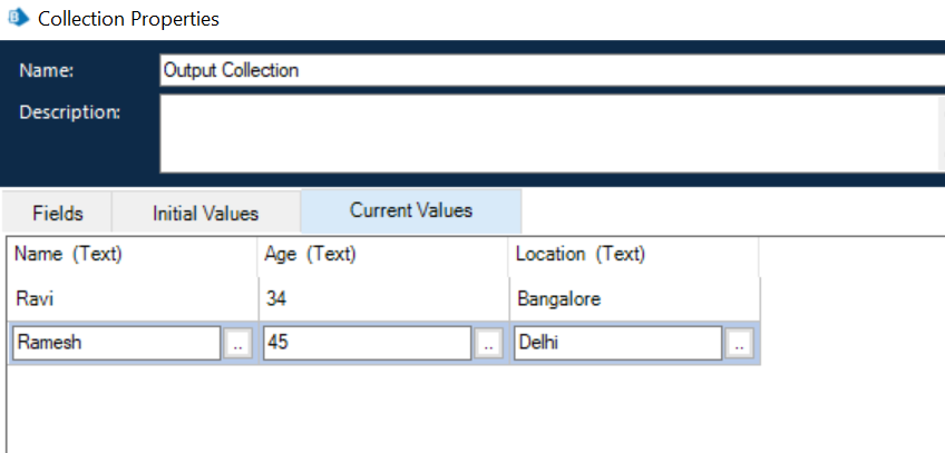

The run results are as follows:
Input Arguments:
Output Result:
You can publish the action and test the same from Process Studio. Let us know if this helps you out 🙂

Hi Vinod,
Where grp.Count=1 _
Input Arguments:
Output Result:

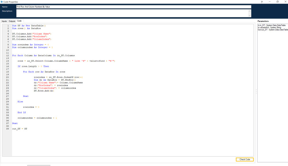

I need a help where I have a code C# needs to convert to VB.Net. Can you help me out. The code helps in to "Find Row and Column Numbers by Value"
DT = new DataTable();
DT.Columns.Add("Column Name");
DT.Columns.Add("RowIndex");DT.Columns.Add("ColumnIndex");
int rowindex=0;
int columnindex=1;
foreach (DataColumn Column in in_DT.Columns)
DataRow[] rows = in_DT.Select(Column.ColumnName+" Like '%"+valuetofind+"%'");
if (rows.Length>0)
{ foreach (DataRow row in rows)
rowindex = in_DT.Rows.IndexOf(row)+1;
DataRow dr = DT.NewRow(); dr["Column Name"]=Column.ColumnName;
dr["RowIndex"]=rowindex; dr["ColumnIndex"]=columnindex;
DT.Rows.Add(dr);
} else {rowindex = 0;
} columnindex=columnindex+1;
Note : Also Can you suggest how to convert code from C# to VB, is there a simple way to understand the syntax or any tool which helps in conversion. If possible can you share/make a video/document on it.

Hey Vinod,

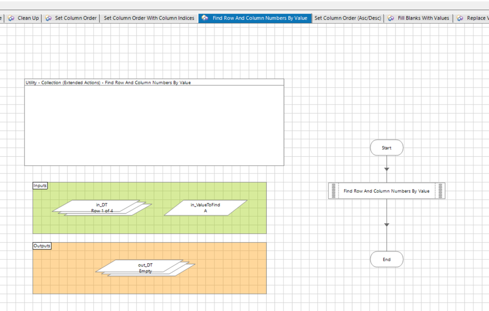

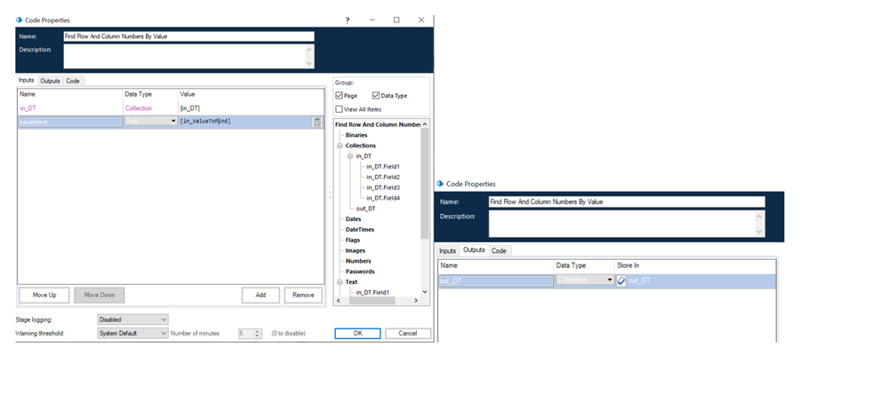

I went through your code and have converted the same into VB .NET. You can extend the 'Utility - Collection Manipulation' VBO by creating the action 'Find Row And Column Numbers By Value' with the following input and output parameters:
Input Parameters:
in_DT (Collection): The input collection consisting of the data where the operation needs to be performed.
in_ValueToFind (Text): The text value which needs to be looked up for in the input collection.
Output Parameters:
out_DT (Collection) : The output collection consisting of the Column Name, Row Index and Column Index where the values are found.
Workflow:
Code Stage Parameters:
Code:
Dim DT As New DataTable()
Dim rows() As DataRow
Dim rowindex As Integer = 0
Dim columnindex As Integer = 1
For Each Column As DataColumn In in_DT.Columns
    rows = in_DT.Select(Column.ColumnName + " Like '%" + valuetofind + "%'")
    If rows.Length > 0 Then
        For Each row As DataRow In rows
             Dim dr As DataRow = DT.NewRow()
             dr("Column Name")= Column.ColumnName
             dr("RowIndex") = rowindex
             dr("ColumnIndex") = columnindex
             DT.Rows.Add(dr)
         Next
    Else
         rowindex = 0
    End If
    columnindex = columnindex + 1
Next
out_DT = DT

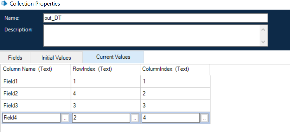

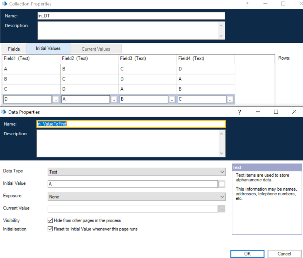

Test Results:
Input Arguments:
Output Collection:

Thanks Dev. Code works Perfect!

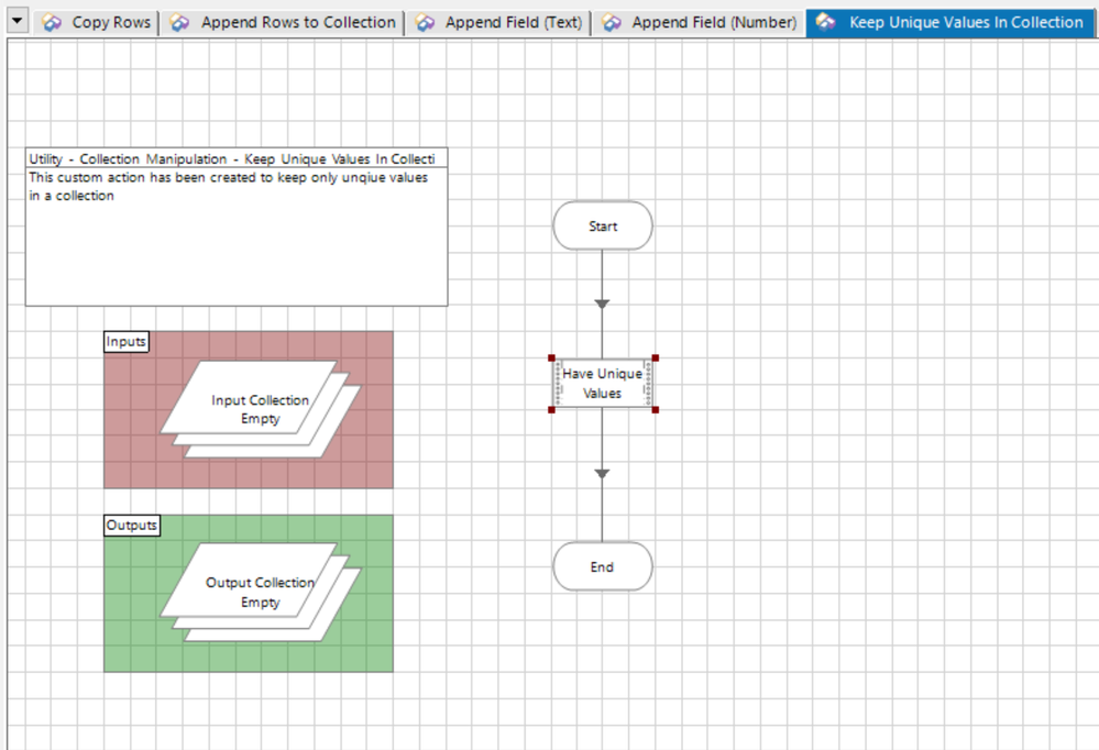

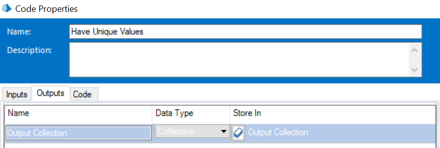

Hi @Gabriela Esquivel,
Thanks for reaching out to community. Wanted to check what exactly you mean by review all columns to identify duplicated values? From what I perceive it is that you want non-repeating records ​based on all the column values just except any one specific field name. If that is your requirement you can achieve the same by adding a simple action in the 'Collection Manipulation' VBO:
Code:
Output_Collection = Input_Collection.DefaultView.ToTable(True)​
