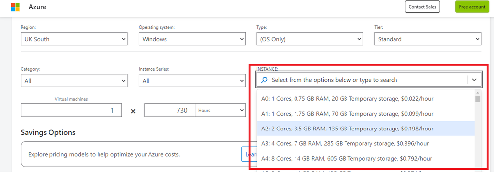

The reason for my ask is there are different combination of instances mentioned in the Azure pricing calculator in terms of CPUs, RAM etc as shown below and will be required while creating the VMs in Azure.

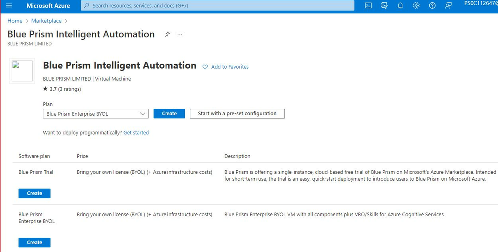

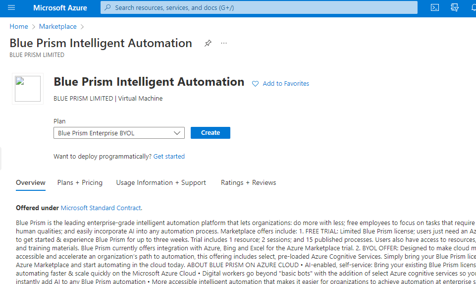

In Addition, I found Blue Prism image in the Azure market place as shown below but the version details are not mentioned over there. Can anyone please confirm on the same?

That is correct; we dont have different requirements for cloud and on-prem. We recommend following the documentation and then considering the additional software that will run on the RR.
Please, take a look at our Online Help for this document."Deploying to a virtualized or cloud environment" has an example of minimal requirements for this environment.
