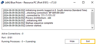

Recently, we've updated to version 7.3 of Blue Prism and we're facing a problem with the control room resources. A resource is in an idle state but, at the same time, the connection is disconnected. I've already tried restarting the service on that machine. The strange part is that I can open Blue Prism normally, but I can't run any processes in the control room.

I've tried looking on the logs, but the service started successfully
