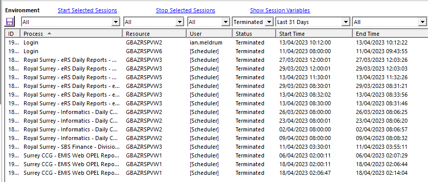

We are in the process of improving our RPA Dashboard. I am currently having to manually collect the volume of Terminations over the past 31 days via Control Room - see screen grab below - and would like to ideally automate it.
I have some automation which captures the normal queue metrics but can't see anything that collates the terminations.
Does anyone have any ideas or suggestions?

You can definatley  able to do by querying couple of tables in  database but it is not recommended pulling directly from prod  database especially you want the dashboard in real time, I think verify whether you can pull data from data gateway.
In case if you are not able to pull from datagateway the other approach is mirror the existing prod database  and create stored procedure to call the data you required.
Even mirroring database is not possible then create a stored procedure from existijg database and  call that stored procedure.

If you are not always using queues or there are other reasons why you want to use the session logs instead, there are some options but they need to run some queries on the DB. Those queries are similar to what happens when you retrieve logs in Blue Prism Client Control > 'View log'. Just try to avoid querying too many logs/days at once and as infrequent as possible and avoid read locks.
There are Scheduler logs [BPAScheduleLogEntry]. They will show you the same information as available in BP Client Control > Scheduler\Reports\Recent Activity
And there are Session logs [BPASession] & [BPASessionLog_Unicode] (or [..._NonUnicode]) that is also the source for what is shown in BP Client with 'View Log'.
