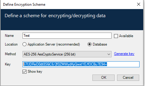

Hi Team,
I have generated an AES-256 key in the BP system tab (use of function "generate key", as illustrated in the image hereafter).
Because of the method used (AES-256), I expected a key with 32 digits, but there are 44 digits.
This 44 digits key can't be read by another software that requires 32 digits with for AES-256 method.
How to transform this 44 digits key into a 32 digits key so that the external software could decrypt datas that have been encrypted in BP with this key?

Hi Guillaume,
the displayed key is Base64 encoded. If you decode the key with a Base64 decoder e.g. Convert.FromBase64String (.NET Framework) you will get 32 bytes binary data as you need.

Hello @Tobias Arnold,
Thanks for your suggestion.
I am currently using online Base64 encoders to decode the key I found in Blue Prism.
However, I am unable to decrypt with the keys I got from these sites such as https://www.devglan.com/online-tools/aes-encryption-decryption.
I get errors such as Invalid AES key length: 52 bytes.
So, if a text was encrypted externally, how will I decrypt it with/in Blue Prism.
And if I encrypt with Blue Prism, how to I decrypt it externally?
