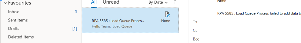

I am using the new outlook Email VBO - V 10.2.4. I created the new object to save email as draft by using the send email code by removing the mail.send.
I am getting the following error message randomly for the same input
"Could not execute code stage because exception thrown by code stage: Object variable or With block variable not set."
