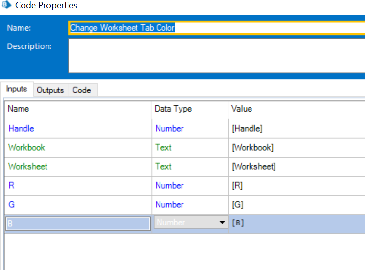

Now, you need to create a new action in your already existing Excel VBO business object named 'Change Worksheet Tab Color' and provide the following input parameters to your action:
Handle : This is a number type data item which will hold the current session dictionary value.
Workbook : This is a text type data item where you need to pass the workbook name that you might get from 'Create Workbook' or 'Open Workbook' action.
Worksheet: This is a text type data item which indicates the name of the worksheet in your excel workbook file whose tab color you want to change.
R : This is a number type data item which can consists of value ranging between 0 and 255 in order to determine the red color pixel in your RGB color combination.
G : This is a number type data item which can consists of value ranging between 0 and 255 in order to determine the green color pixel in your RGB color combination.
B : This is a number type data item which can consists of value ranging between 0 and 255 in order to determine the blue color pixel in your RGB color combination.

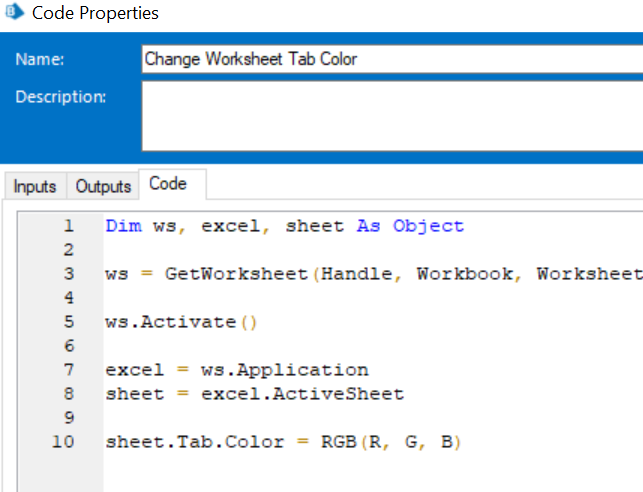

Now, you can add a code stage named 'Change Worksheet Tab Color' and add the following inputs parameter and map the data items to it:
Code:
Dim ws, excel, sheet As Object
ws = GetWorksheet(Handle, Workbook, Worksheet)
ws.Activate()
excel = ws.Application
sheet = excel.ActiveSheet
sheet.Tab.Color = RGB(R, G, B)
You should have your workflow ready as shown below:
Code:
ws.Activate()
