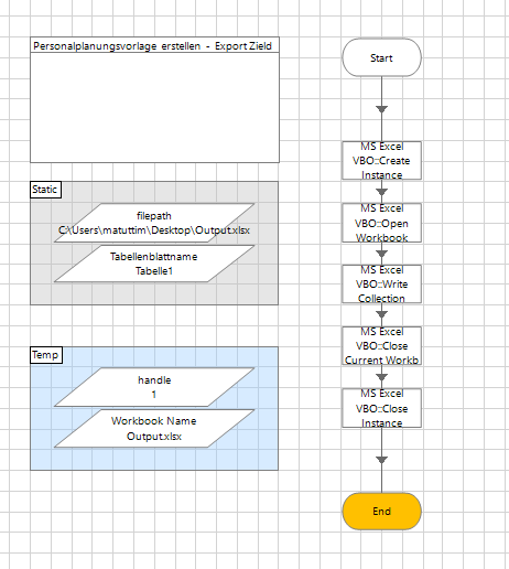

I have a small process that works with data from excel tables.
I basically import c Excel files as collections.
INPUT:
Prozessmodell.xlsx -> collection 1 named INTER-Prozessmodell
Vorlage.xlsx -> collection 2 named Zieldatei
I take specific data from collection 1 and add it to collection 2 and in the end collection 2 needs to be exported as an excel file again.
OUTPUT:
collection 2 -> Output.xlsx
My Export Page looks like this:

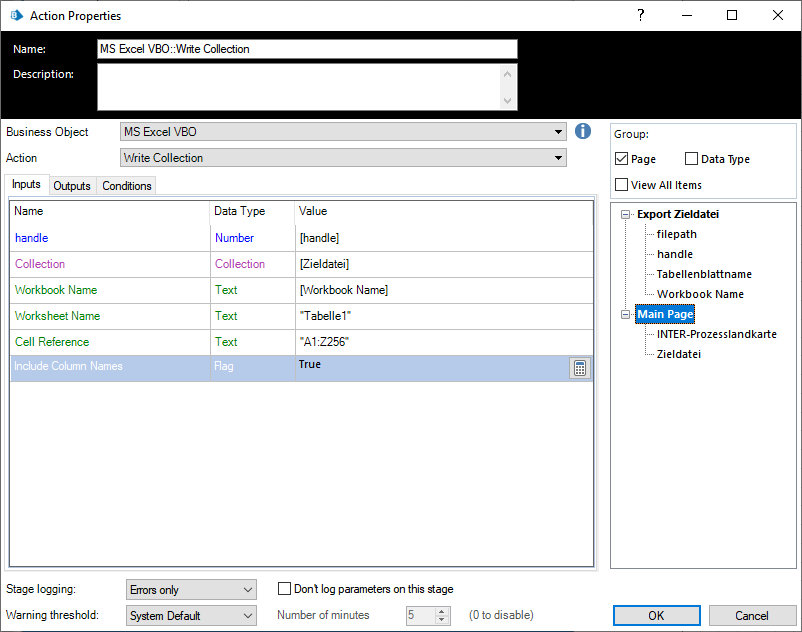

16414.pngMy Write Collection stage:
When I execute the stages it actually looks and feels like it is actually doing something since it takes some time. But when I open the Output.xlsx file later it is always empty.
Anyone got an idea what I'm doing wrong ?
Is there a documentation on these specific excel functions and if so, where can I find it ?
Also a in depth documentation for all the actions would be great. If anyone has a link I would be glad.

I think I'm a little bit further to the solution I'm looking for.
I removed the open workbook and close current workbook stages and changed the Cell Reference to A1 in the Write Collection stage.
Now Blueprism asks me to provide a filename and lets me save the changed collection after the close Instance stage.
Somehow it does not automatically save to the already existing Output.xlsx

While debugging it, you could insert a 'Show' action just after Create Instance, and that way you could watch what it does on the screen. Helps a lot. I would remove the 'Show' action afterward for prod because I believe it'll go slower with it displayed on the screen.
If you're looking to write out to a new Excel file that doesn't exist, then the order would be this:
  1. Create Instance
  2. Create Workbook
  3. Write Collection
  4. Save Workbook As
  5. Close Instance
You may also want some additional actions in order to create a new sheet instead of just using Sheet1 and what not, but the above should at least work.
