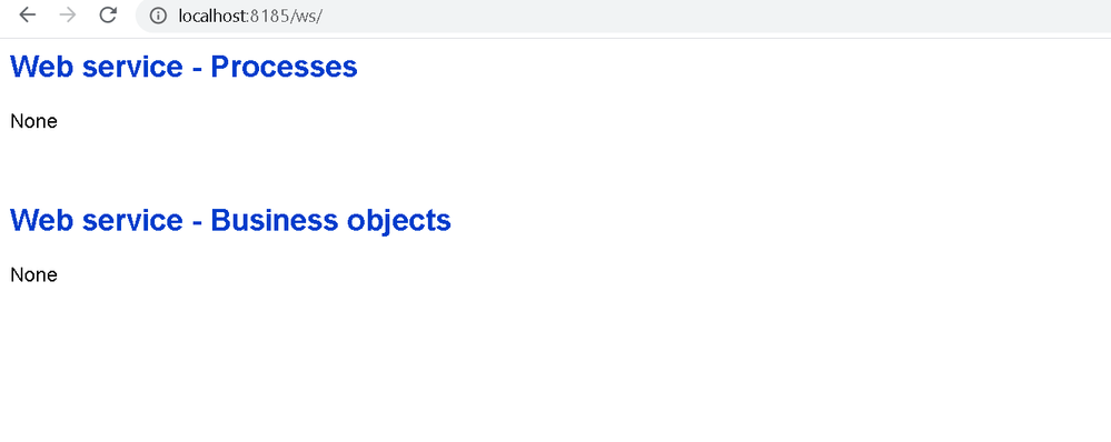

Hi Bherminder,
a few questions -
1. Is your RR running (with studio or standalone) in control room/
2. Check your C:\Windows\System32\drivers\etc\hosts file. to check if localhost is mapped.
3. if no mapping, add an ip host mapping.
4. check if the port is correct.
5. Ideally i check this by running a new RR (not one from control room), create a bat file in the local system and add line : "C:\Program Files\Blue Prism Limited\Blue Prism Automate\Automate.exe" /resourcepc /public /port 8185 (or equivalent)
6. Run the bat file, you should see the runtime connecting.
7. Open chrome and check - http://localhost:8185/ws/
8. I can see below page -

a few questions -
