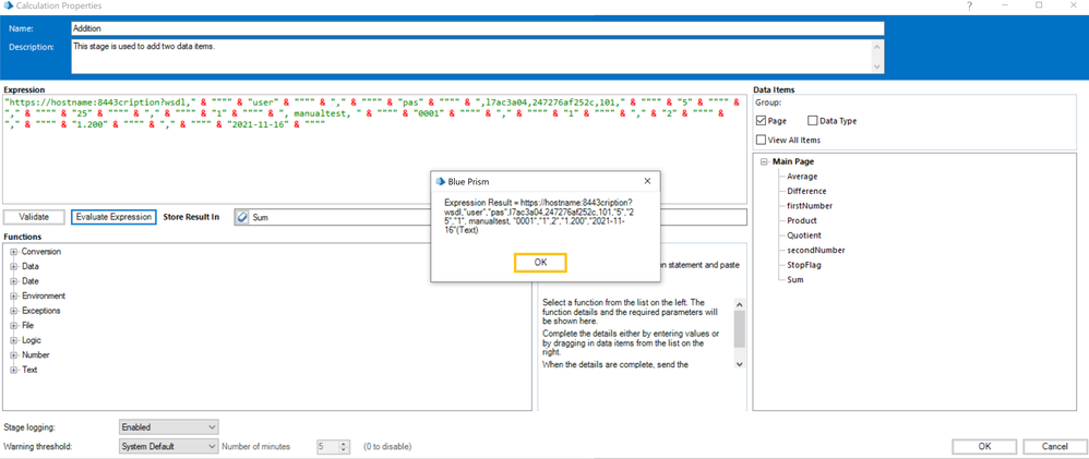

Hi @sastharpa,
Glad to know that you found a resolution, but the syntax I gave is not incorrect as you can see from the below screenshot:
Many times, I have seen that directly copy pasting expressions do cause some issues in some machines​ which I think text editor for the expression screen does not recognize properly. If you try to copy few sections at a time as well on each go, you should be able to get it work, I think. ​
