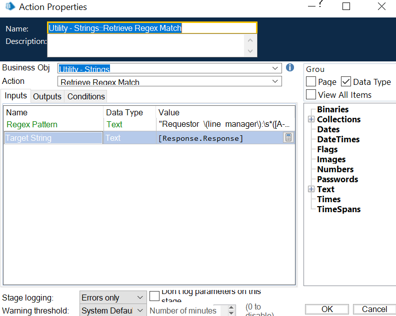

Hi Andre Köpplin, Please refer below steps to solve your query -
  1. Use Utility String - Retrieve Regex Match : "Requestor \(line manager\):\s*([A-Za-z]+\s[A-Za-z]+)\s*(?:<br\s*\/?>\s*|,)\s*Requestor \(line manager\) ID:\s*(\d+)\s*(?:<br\s*\/?>\s*|,)\s*Impacted employee:\s*([A-Za-z]+\s[A-Za-z]+)\s*(?:<br\s*\/?>\s*|,)\s*Impacted employee ID:\s*(\d+)\s*(?:<br\s*\/?>\s*|,)\s*Required action:\s*(.*?)\s*(?:<br\s*\/?>\s*|,)\s*Document type:\s*([A-Za-z]+)\s*(?:<br\s*\/?>\s*|,)\s*Reason of issue:\s*At request of employee\s*(?:<br\s*\/?>\s*|,)\s*Letter language:\s*([A-Za-z]+)"   29510.png

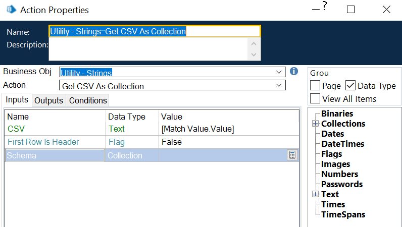

  3. Call Action Get CSV as Collection and Set Output Collection:29512.png

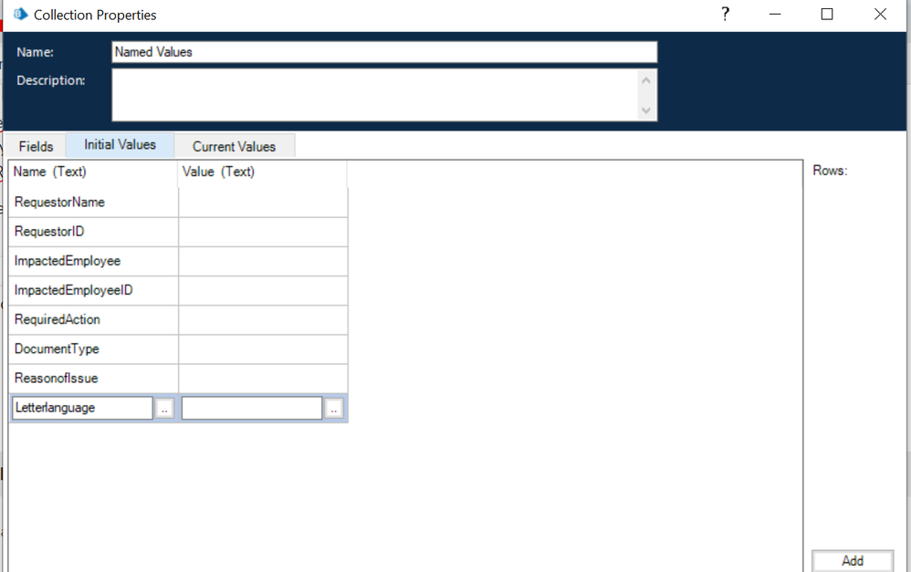

Other option as to do as well with Utility - Strings ( Extract Regex Values)
[\<br\s\/>]+[Requestor\(line manager\)\s]+:(?<RequestorName>[\w\s]+)[\<br\s\/>]+Requestor \(line manager\)\sID:(?<RequestorID>.*)\<br \/>Impacted employee:(?<ImpactedEmployee>.*)\<br \/>Impacted employee ID:(?<ImpactedEmployeeID>.*)\<br \/>Required action:(?<RequiredAction>.*)\<br \/>Document type:(?<DocumentType>.*)\<br \/>Reason of issue:(?<ReasonofIssue>.*)\<br \/>Letter language:(?<Letterlanguage>[\w\s]+)\<br \/>
Build one collection with the group names as below
Output will as this
Note - Group names should not contain spaces
Hope this will help
