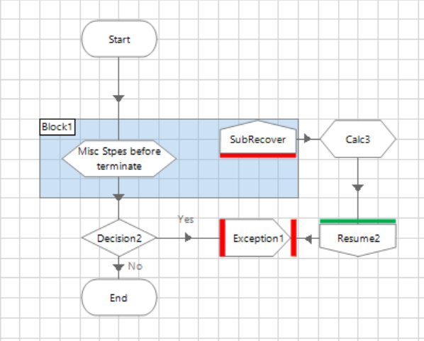

Hi Mayank,
As you had mentioned that you are not sure whether BOT may/may not get error at 'Misc' calculation stage. refer screenshot and try to proceed in that manner to avoid infinite loops.
Refer below screenshot.

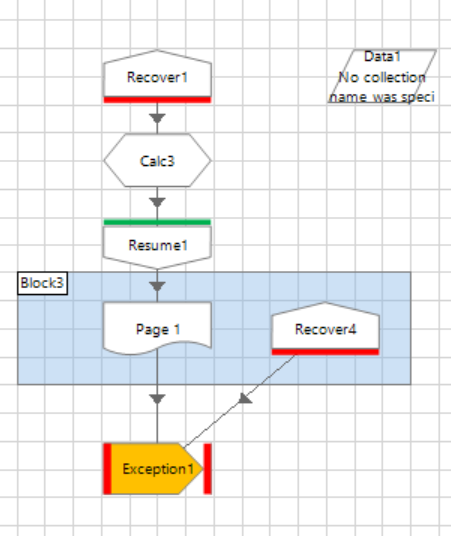

As i am passing Data1 item error message into "Page1" (new page)
In 2nd image (i.e., inside the page where you need to keep your Misc calc stage) if you have any error message there, append error message to actual error message and throw, else throw back the same error message what you got into this page as input param from Main page.
Let me know if you are not clear in understanding this.
This will work.
