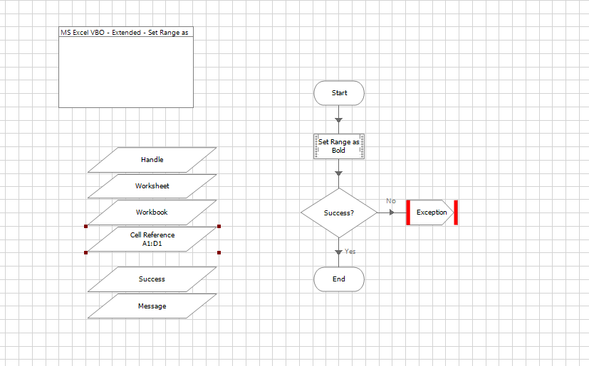

Hi Alex - You can additionally create a custom action in one of your extended or MS Excel VBO to Set Border, Set Bold  basis on Range:

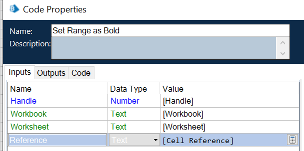

Add Inputs and Add a code stage in one of your newly created Action in your custom MS Excel VBO:
Add below code in the code Stage (Highlighted in Red are two actions for Bold and Border, you can remove( range.Borders.LineStyle = 1 ) if you only require Bold action, additionally if you want to colour your selected range Add one Additional line or copy paste the same code in new action and just replace the highlighted in Red lines in code by ( range.Interior.Color=RGB(R,G,B) ) and you would have to provide additional 3 inputs for R,G,B for colouring  :

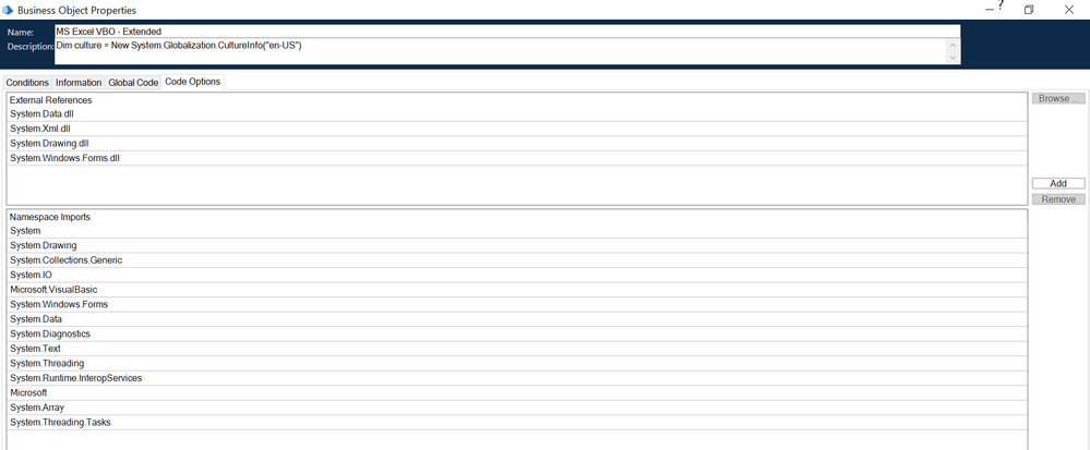

Make sure you have all the Libraries and Namespaces listed in the Initialise page:

We have an action to put in the MS Excel VBO to do it
Mukeshh_k
